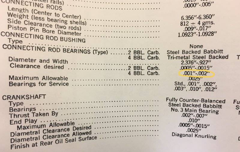

I like the idea of .002” next time. My manual says .001” a .002” for the 4 barrel, so I thought I was fine.
When going with conventional SAE or multi weight oils of 30 and heavier, there is a rule of thumb that is safe that says for every inch of material diameter to allow for .001 inch of oil clearance. That being said, .0024 on the rods and .0027 on the mains is usually good on a B engine with a good high volume oil system. Sometimes to achieve the proper thickness it takes .0005 under sizes bearings mixed with standard bearings with the thicker o.s. shells in the top of the rods and in the main caps.
Wow. .001 doesn't leave much room for error.
One of the disadvantages of closer bearing clearances is that it can raise both bearing and oil temperatures. That’s no problem as long as the bearings and oil can handle the heat, but if they can’t it increases the risk of lubrication breakdown and bearing failure. The tighter the clearance, the more critical perfect machining has to be. Perfectly round, straight and smooth journals. That’s why high quality synthetic motor oil is the norm if you are building an engine with tighter than normal clearances. Don't be afraid to use an oil that starts with a zero.
You have something wrong somewhere. 0015 is a little tight but would not cause what I see. I've ran as tight as .001 on stock cranks and never had a bearing problem, but had some easy break in time after cam break in. If I have a crank turned I shoot for .002 to .0025 on rods and mains. A lot of them old speed pros call for clear down to .001 clearance. No way I would go under .003 even if it called for it to be .001to.002. I had built an engine with .001 and it locked up after cam break in. Just to much heat on break in. Scuffed the walls pretty good.
