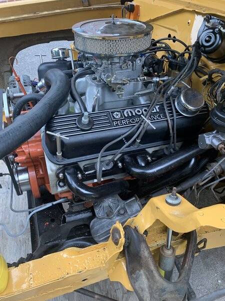

Here it is on a 340. It’s just the throttle cable, bracket and springs. The trans is a manual shifting 904, no kick down cable needed.
The instructions are easy to follow. Read first!

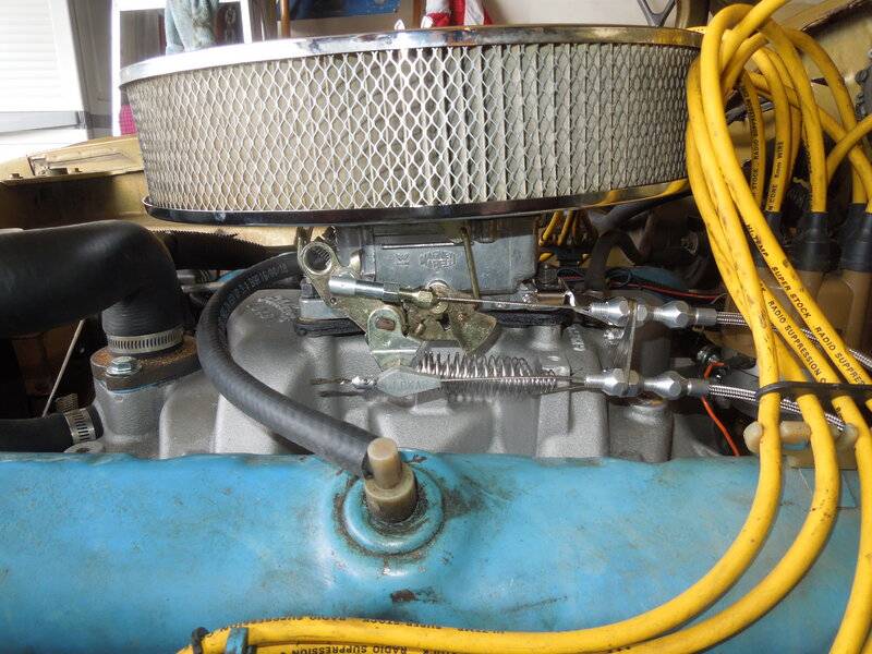

I used Lokar throttle & "kickdown" cables too, for the Edelbrock LD4B intake and Edelbrock 1406 600cfm carburetor on my car about 5 years ago.
They worked so well, that my engine builder/mechanic re-used them when he rebuilt my engine last winter.
