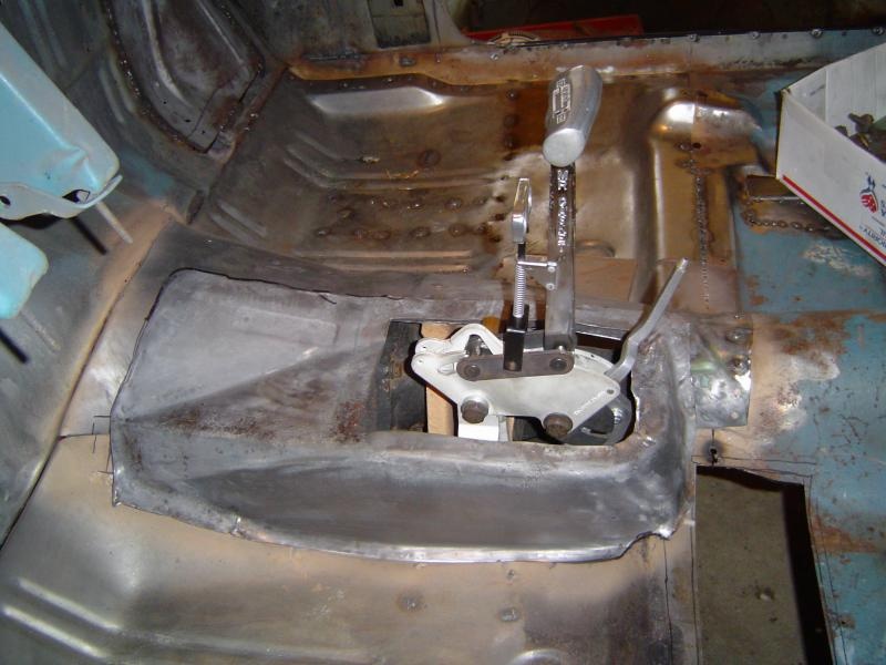

I'm just about ready to weld in my hump. I'll take some pictures and get some measurements for you tomorrow.

Here's a few shots of what I'm putting together. The floors on both sides are new and the tunell is from a doner. The hump is original from the car.
As you can see I'm using a V-Gate. If that thing fits in there then any other shifter will fit as well.
If you need more let me know.
Ted

go to my build progress u will see pics of my hump i just installed
You'll notice the floor has contours , the hump is contoured also , it's not to hard to figure out where it goes once you drop in on the fllor pan. do as the person that put the pictures above did , drop it on , trace it out , go an inch or so inside your tracing and that is what you cut out .
