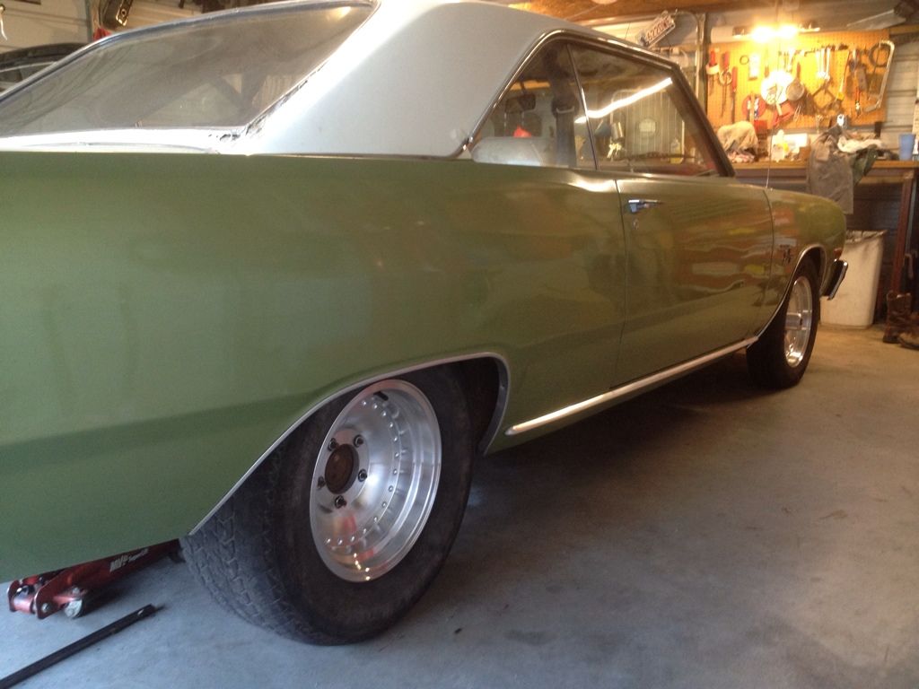

I have my 74 dart i am building for the 2013 Hot Rod power tour. i am going to take out the \6 and replace it. I have a freind that owns a large salvage yard. he has offered me a 440 / 727 out of a motor home 62,000 miles. i don't know much about bb dodge stuff. so is it the same as a car block and are they worth messing with.
use it. you may need a car 727 tailshaft , an oil pan, exhaust, mounts, driveshaft, torsion bars to include a brake upgrade and rear end, which im sure is already in the plan. there is nothing "special" that would prevent you from using it.
I narrowed a 9" this weekend and put it in, I had already relocated the springs. Thanks
