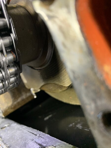

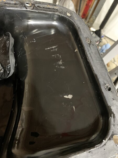

The oil pan has a strange witness mark(s) on it, but it is not possible that the counterweight or rod hit it. This part is under the first main cap, and more toward the chain.
First pic is with off engine, second is just dry fit to show where it is. It is even farther away from the counterweight than the pic suggests, I am not great at pics lol
Any thoughts here?
Any thoughts here?
Rotate the crank 180, the connecting rod bolts stick out the farthest. but that is a long ways away.
Rod bolts are wayyyy far away, turned it all the way over and there is nothing even close to these marks… it’s bizarre.
It may have zero to do with my noise situation but when you see marks like this it sure is a head scratcher
