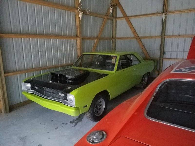

Show pictures or it never happened. lol
It happened alright!!! This was taken last night 9/13/18 at the final local 300 foot drag race of the season. I couldn't be happier. I still have some work to do on putting the power to the ground.....but for a newbie, I was pleased with my first attempt.
