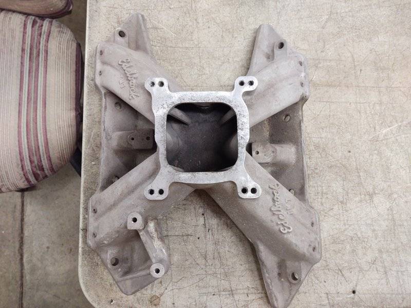

The intake on the engine in your first post is an original Torker, not the T2.
T2-
