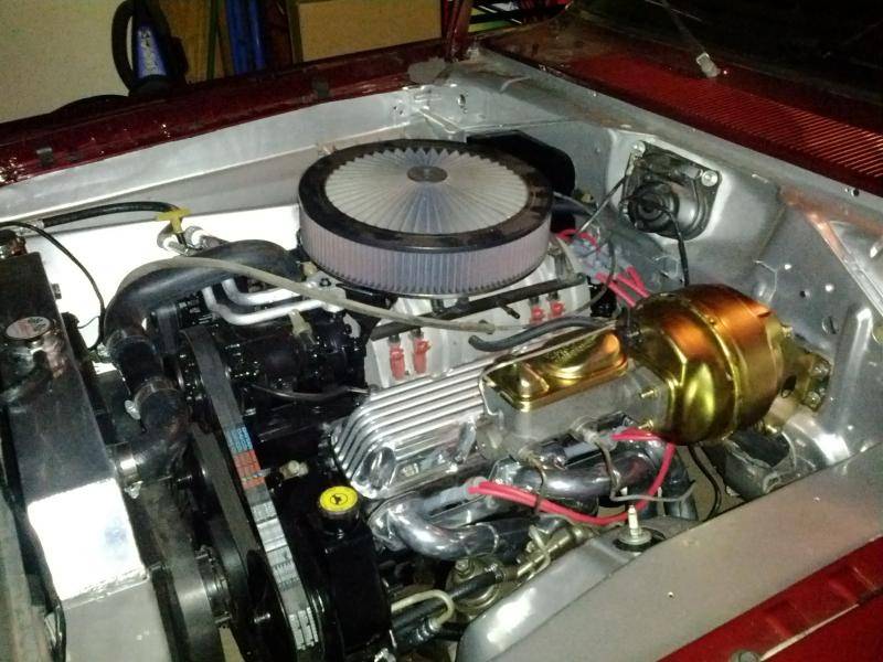

Alright, we pulled the motor last weekend and it's now in my garage. I might start a thread for the swap, but to close out this thread I've posted a couple pics below.

I thought I read the stock Magnum intake doesn't fit under an A-body hood...? It is fairly tall
This is in a 71 Dart.
With the shorter throttle body, I don’t think it’s much, if any, taller than an air gap and carb.
Is that your car? I'm about ready to start plumbing A/C on my 5.9 in my 70 dart. It has factory air and I have the Magnum compressor and hoses. I would like to see more pics if possible.
