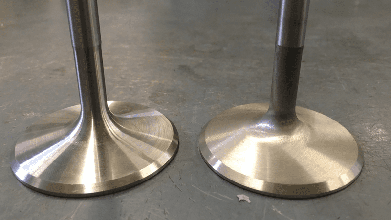

Final valve job, .007" resurface/wash and assemble. Springs are 155lbs @ 1.950" 425lbs @ 1.400". Should have them torqued to the shortblock today. Also a shot of the squared up cleaned up ports. J.Rob
Hey you stopped short of that dam shortside. Lol
