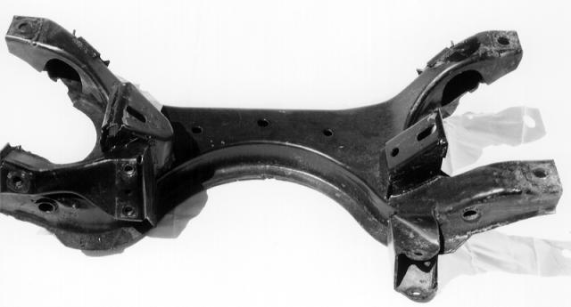

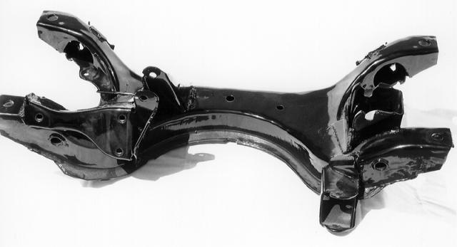

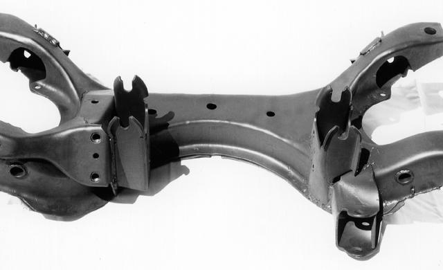

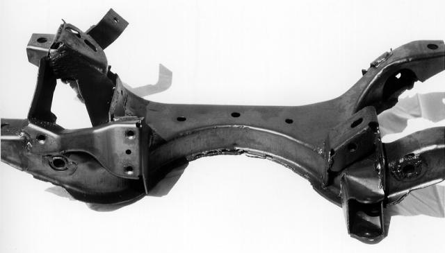

Sample pictures.
attachment.php
attachment.php
My understanding is the washer is 70-later thing or thereabouts. If you want to beef up the LCA pin tubes go ahead, but you will likely gain nothing changing to a V8 k-member because it is likely that none of the critical areas are different because it is likely to be a 318 k-member.
BUT, if you can get a 73-76 V8 k-member with spool mounts you can build a big block k-member out of it without needing Schumacher mounts...
I was just looking over the pictures above and the '67-69 A-Body Original B/RB K-Member clearly has those half moon/C washers on the lower control arm pivot mount but the V8 biscuit mount K frame doesn't have the half moon/C washers. Members have posted quite a few threads with them broken and wallowed out so I would add them.
Add says out of a 71 340 car. Don't see any washer, though. Sounds like what I have now is going to be good enough and just needs conversion mounts. Thanks again. Great support.
