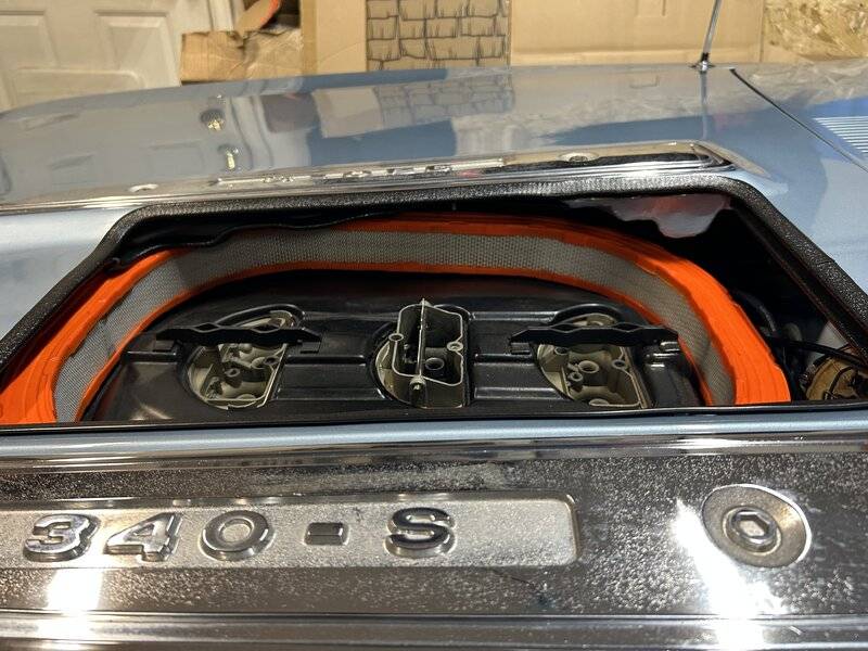

Here is my stock hood ‘67. It fits but is very close. Mine is cut for the tunnel ram.
