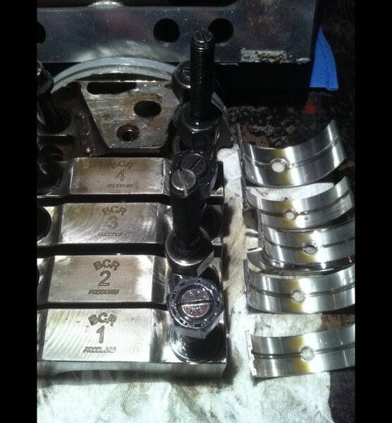

There was someone on moparts who claimed magnum blocks had more material in pan rail and main web and even had comparison pics. Also believed they had a better nickel content. I’m building a 650ish hp motor with a 98 magnum block and billet aluminum main caps. Block passed sonic check.

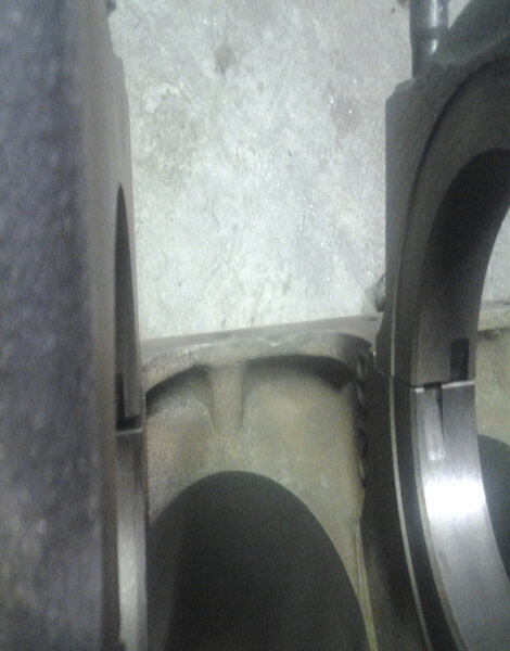

I found the thread showing photos of pan rails and weights of a bunch of la vs magnum blocks. Take a look, decent amount of samples
Stock SB block info
Is the first picture that comes up indicative of all of them, because that’s not a filled pan rail from what I could see in that picture. Plus it needs to have the main bearing bulkheads filled in and I couldnt see from that picture.
There’s one attachment showing a typical la pan rail and another attachment a couple post down showing a magnum rail. While not a race block I definitely see a difference between the two
Magnum looks slightly beefier, but not night and day stronger.
Yea, I think so too, slightly more material from bottom of bore to pan rail. Guy who posted pics had quite a few samples so I’m assuming this is how most of them are

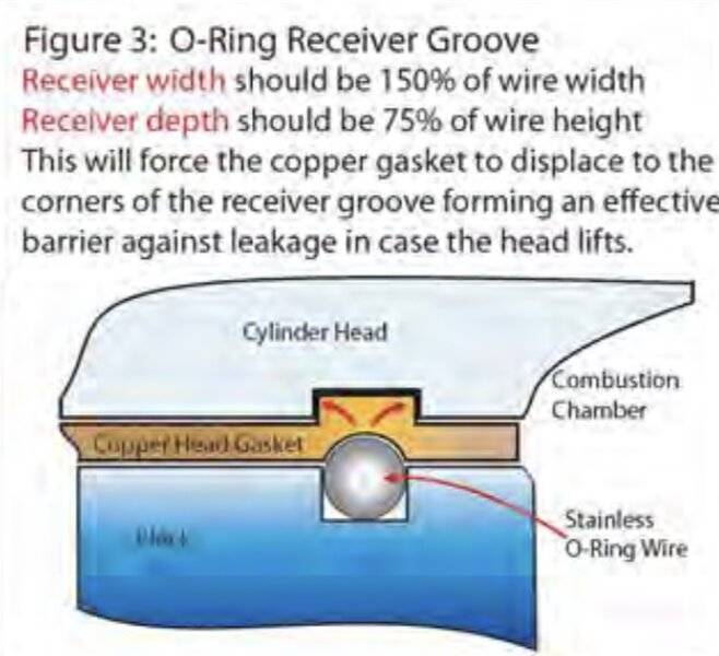

My heads are O-Ringed with receiver grooves cut in the block.
