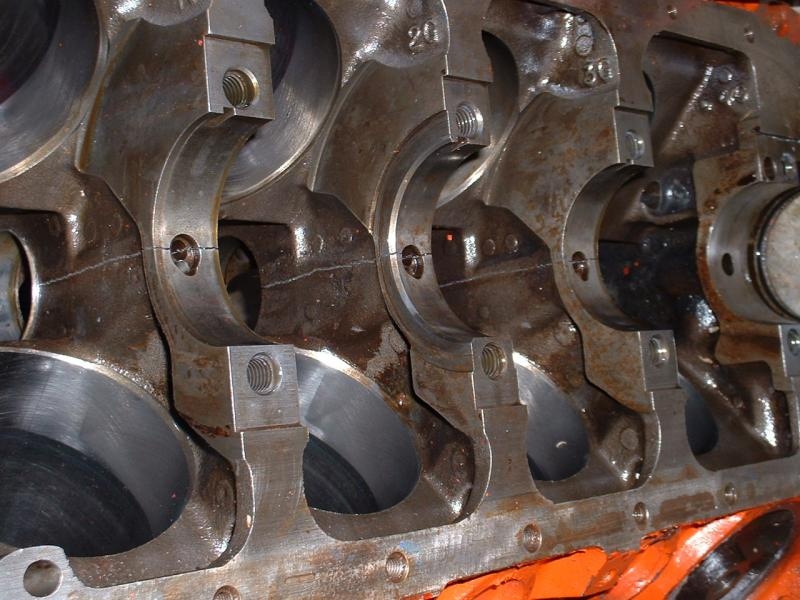

Here's something for you to ponder, this is just a pic I downloaded from the net quite some time ago, there may have been other info with it at the time but it's long gone now, just posting for interest sake. Whatever happened to it is anyone's guess, but whatever it was it didn't like it much!!!

WOW AND THERE IT IS A CRACKED BLOCK!
Cyl bores say it didn't run vary long!!!!
That block doesn,t even look like it was run.Wouldn,t there be oil in them there cracks?:wack:
I have seen that picture before but it was a long time ago.
It is weird looking and suspicious with no oil stains in the cracks of that block. Maybe it was ran with no Oil?? Looks like there is oil everywhere else.
Photoshop?? I dont know but by Scott you are onto something!
If it is Real,,, The good on this subject out weighs the bad 100-1 so far.
Still with no real first hand experience of a block breaking at the 600hp level or as a matter of fact at any Power Level! All blocks in this thread were broken due to other parts around them failing in one way or another, I think we can all agree on that.
We have turbodart68 Shattering the Myth with 911HP & 890ft lbs to the TIRES with over 150 Runs down the 1/4 mile & No breaks. That is over 1000 Crank HP and ran hard at that.
Thanks all and keep the posts coming. We can all learn something from this.
That cracked block looks run, you can see the ring lines where they bottom out in the cylinders. I'd guessing severly unbalanced block with way too much boost or N2O or dropped off an engine hoist,,,,ouch either way.

hahahahaa! I hear ya! That pic of the crack is the same place the 5.0 likes to crack. Seems a good thick full length girdle would help. My 2.0 has all the caps and pan rail made into a single "bedplate", pretty cool if someone made that for an SB.
I did crack a Ford 289 block like the above picture. It was a throw together motor for my old Ranger I had while I was building the good one for it. Was beyond out of balance. Truck spun 3600 or so rpm on the freeway. Does not take much of an imagination to figure out why it happened, but it did run several thousand miles, a good portion of it with the go pedal in the floor board off roading.....
