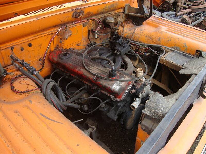

but more along the lines of this thread... that engine that I picked up to get the adapter from.... I strapped it to my trailer, stood it upright (or at least as upright as a /6 is supposed to sit) and put the home made wood blocks where they were meant to go, strapped it to the deck of my trailer, got the battery out of my dead durango (dead, until I can get the parts for its 314k-mile 46RE tranny) set battery on trailer deck, connected the cables from starter and block, plus a jumper to the coil, splashed some gas into its Carter BBS, cleaned the points with emery cloth and contact cleaner and.... IT RUNS after having sat for I have no idea how long on a dirt floor of a barn...... I want to dig up a length of fuel line and dip it into a gas can and let it run for a few minutes instead of just as long as a splash of gas into the carb throat runs..... it has rad hoses, maybe rig up a radiator to stand up in front of it???? (forgot the screwdriver between the starter terminals to make the starter crank..... haha
But being this combo has a "rebuilders industry standard" #3257 Mopar starter (autozone sticker still on starter that came with it) I'm wondering if maybe there won't be anything needing to be ground out on this adapter? I remember others talking about some "direct drive starter" with a different tooth count on some models, maybe only those need whatever "ground out," to use this adapter on a /6 and an A500/518???? Were there different variations of the adapter?
From what I have read, it was used til '68/69 depending on who's talking. This crosses over the small/big crank pocket on a /6, and also the conversion between A/LA V8s.... did the V8s also have a small crank pocket? I've heard that no 727s did..... Ive heard early 273s did/didn't have a small crank pocket just like the /6 had.... don't know who to believe on that one.
This /6-727 has//// 3 freeze plug block so its an "early" 225.
cartridge oil filter
rebuildable fuel pump
il sending unit on side of block above oil pan rail instead of on the oil pump
has point dist., with the "oil cup" with spring loaded cap
front sump like Ive never seen on any Mopar engine
oil bath "bug catcher" air cleaner assy. attaches to carb by clamp similar to what a diesel turbo exhaust has..... (that I didnt get with this combo though I got the air cleaner)
trans... cable shift
brake drum/park brake on end of tail. including park brake cable still there
a flat flange bolted to drum, with a splined slip shaft yoke still attached by the U joint. reminds me of 70s motorhome applications.... not ball and trunnion.
a weird "loop" on top of tailshaft I have never seen before/ though I've heard the truck versions back then were hung from top? also has typical 727 flat flange for more common style of mount on bottom of tailshaft
a hole in top of bellhousing again like 70s van/motorhome trannys I have had, have had.
only the KD link sticking up thru trans case, since it is cable shift....
the only trans like this I have ever had my hands on, though I've seen more 727s over the years than I can recount.....
I may come back and post any numbers i can find off engine and trans to verify age..... if only for my curiosity.....
Let's see if I can succeed in pix
Only problem I see so far is that in that few seconds of running each time (had it running twice, 2nd time was longer, felt like I had it going for "almost a whole minute" that oil sending unit leaks like a sieve.
Haven't really pd attention I guess but of the other /6s I can remember ever messing with I don't remember another with sending unit mounted there, usually on the pump... But I have the dutra book, and I think that's where I seen it mentioned to drill and tap a port there for additional oil pressure gauge, etc before on engines that don't already have one there.
Spose that would be a good place to supply oil if you're wanting to add a turbo ... Just a thought.
