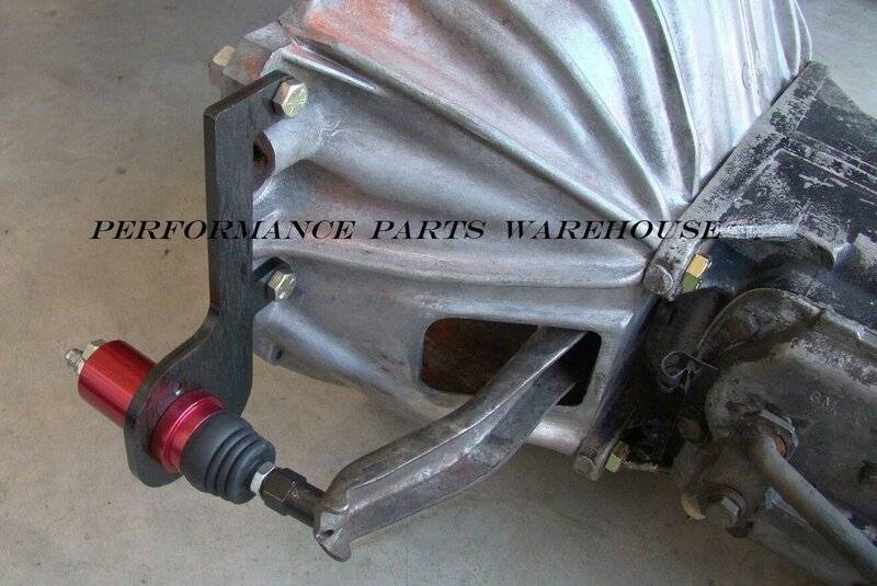

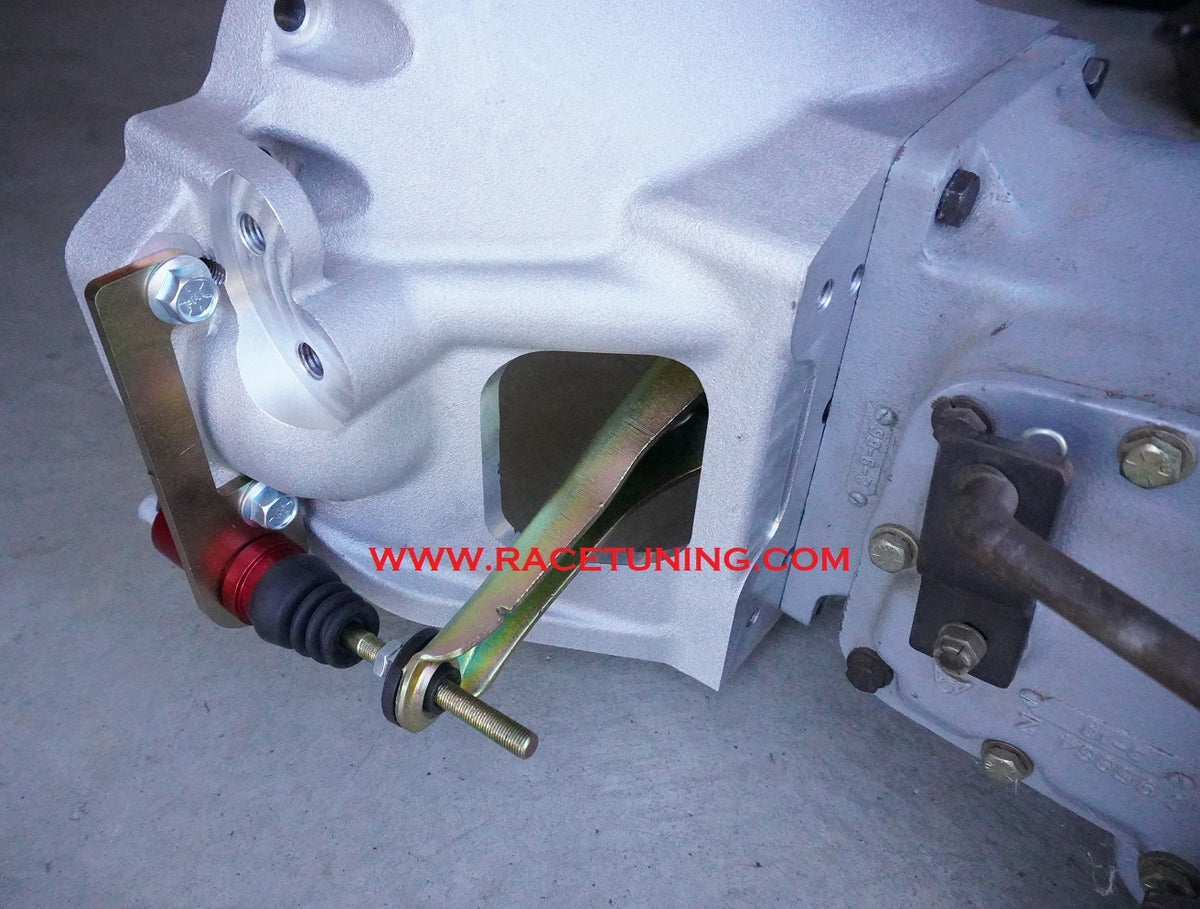

maybe something like this inbetween the exhaust and TO arm. make a nice bracket to hold, then wrap it.
Or this:

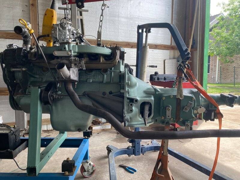

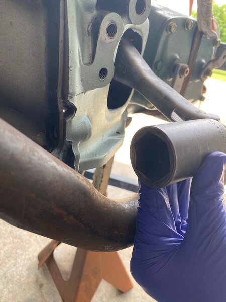

ok, had a little time today to do something before leaving for Philly~ engine/trans setup with exhaust, figuring on an external slave cylinder. Zach's helping me out, but all are welcome to voice.
Oh, the large socket represents a slave cylinder :lol: going to finish packing now~

I'd have to fabricate my own bracket, but that's ok.
I'm looking seriously at this one by Modern driveline, the line going in is at a 90 degree angle and out the side vs out the back. plus it looks shorter, I wish they'd put measurements in their ads. I think I just need
the cylinder and the bracket that it is retained in.

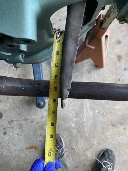

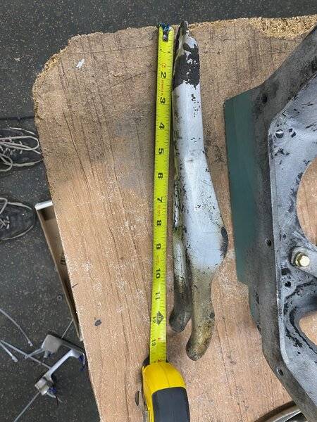

Dne007, you are moving at a great pace and do some nice work, just a heads up the TO bearing fork is too long for early abody, the picture with the tape measure shows about 3 inches to long, the factory rod between the fork and cross shaft fits between the bellhousing and exhaust pipe. I could send a picture by text if you want, I just can't get it to load to my pc. Since you are using 833 OD with larger bearing retainer I don't know if they make a shorter fork to fit that bellhousing, see what Brewers Performance has to say. You could always cut a section out and weld. If this is what you do, then it looks like a smaller bracket can be made to get the slave cylinder away from exhaust pipe with possible heat shield for protection.
Yes, it’d be great if you could get a picture;). My flywheel and new pressure plate should be here on Tuesday(diaphragm). I always thought the one I have now looked a little long:(
If I knew how long, I have another fork, maybe I could shorten it?

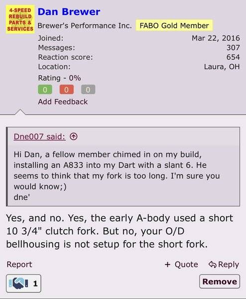

Ed, I hope you don't mind, I posted one of the pics you sent me;) I wrote Dan Brewer and checked on Brewers and can't find anything but one like mine~ just started looking, on the ebay and Brewers
[/URL]
What did @Dan Brewer say? That guy is so knowledgeable based on pictures. When I was building my 4 speed, I had mis matched synchros and hubs (different years) he was able to identify just by a picture. Great guy
