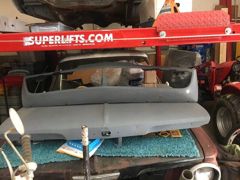

Here’s the one I’m putting on my Barracuda. It looks identical to the one on the car. I suspect the car has a Valiant front clip on it, because the front fenders are 100% from a 65 Valiant. If you find one from a Barracuda, worst case is you’ll have to fab 2 little brackets to brace the turn signals.
they look good no matter what front end you put on them...Just an FYI as I know this is not a part's thread @RustyRatRod there is one with turn signal lights on EBAY right now...it's in PA but they are getting hard to find...it looks pretty good
Valiant and Barracuda valences are different. Valiant has parking lights inside the valence opening. Barracuda opening is partially filled (see the one for sale referenced in post #15). Originally, the filled area was painted black and was not very noticeable, but most today are just painted all body color.
Valiant valences will fit a Barracuda. I have one on mine, because they used to be more readily available than Barracuda valences. Mine was NOS. There are two tabs for the parking lights that I just folded down out of the way.
