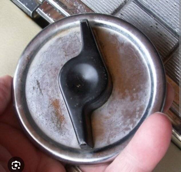

@slantsixdan do know if the "hurricane" style fuel tank cap was a factory item?
If you're referring to the chrome cap with the black "S" shaped handle, no, that is not an original assembly line piece. IIRC, it's made by Stant who is the OEM, but, it didn't come on the cars when they were new. It's a replacement cap and is similar to the '67-70 version, but, the center is slightly bigger on the later one. I've seen many a filler neck ruined trying to jam that later cap on the early filler neck.
I'm not sure what you mean by a hurricane-style fuel cap. If you mean the hinged, flip-open type, then no, that was not available on any A-bodies in North America. If you mean something else, please describe in more detail.
It looks like this (not mine, lol). Thanks!
That's a Stant G-27, aftermarket replacement cap. Handlebar came in chrome and black, depending on production date.
