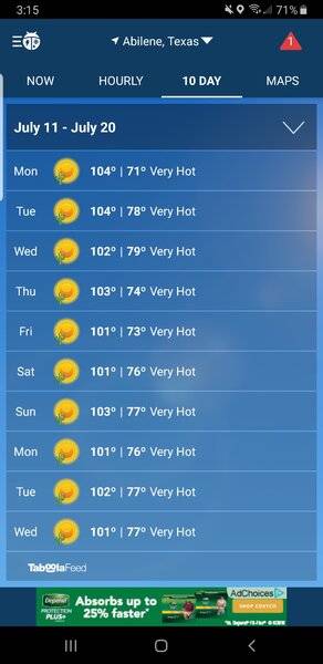

Great to hear you are well on the road to recovery, Matt! I just got the 42RH in place in my Dart and was just thinking of you a couple days ago as I worked to get the factory floor linkage sorted out with the piece that you modified for me. I'll send pictures as soon as it is all working smoothly, but it will be a couple weeks because I'm headed to Carlisle.
yep..... Texas...100 with HI of 113 is toasty!
