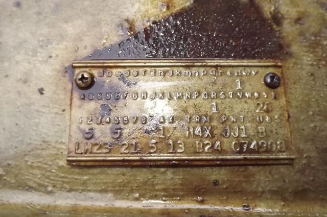

I can decode 69 and up fender tag codes from memory all day long, but the 67-68 format and codes are throwing me a nasty curve ball. I've searched this site, and the web, to see if I could get some schooling on how to do it but I'm just finding anything definitive on it.
As an example I copied the following pic from another thread here on FABO http://www.forabodiesonly.com/mopar/showthread.php?t=236271
attachment.php
So here is what I do know about them. I understand that the lines are numbered 1-7 from bottom to top. Line 1 I now pretty much get as being from left to right: model line/price class/body style; engine; trans; wheel and tires; and SPD. As for the last six digits I'm not so sure - since the example above starts with a 0, and from what I know VINs started at 100001, my guess is that it's the order number?
Anyway, I also get the "AX TRM PNT UBS" codes in line 3, but what I don't get is for example the "1" under the "A" in "AX"? In the original post "ROCKY JS" says it decodes to a 2:76 rear gear - but how would I know that if ROCKY JS didn't tell me? Where is the code breaking table that tells me a 1 equates to a 2:76 rear gear?
The numbers in the beginning of line 3 I interpret as being for certain moldings - but which ones? Once again, how do I know the 2 is for drip rail moldings? What would a 3 or 4 molding be? Where is the code breaking table for these?
Then there are the letters in lines 5 and 7. Each specific letter stands for something but what? About the only one I have figured out is that the capital R on line 5 is for the radio option but that's about it. What are all the other letters for? Where is the code breaking table? How can I get schooled up on this so I can read 67-68 codes off of a fender tag as easily as I can 69 and up codes?
As always, any help on pointing me in the right direction will be greatly appreciated. Thanks in advance!
1 under the A is the axel ratio, if there were an 8 under the X it would be a sure-grip. The coding is similar to the later, but only uses one digit of the code. For example Fender tag code F7 is code 36(7) formula-s. The lines are also similar to the later as to what goes under what letter.

Thanks for the reply Rocky, but I'm still not getting it. Ok, now I see that only the last digit of the code is placed under a corresponding letter. But how do you know what category or group item each letter represents? In your example above you state that a "F7" code equates to the 36(7) Formula-S package. However if I applied my 69 and later code experience I would deduce that the "F" group is for electrical and that a "F7" code might stand for a 62(7) 59 amp battery. So I'm just not clear on this yet. Where can I find a decoder table that tells what each letter "group" on the tag represents? Thanks!

I'm looking, looking, looking, but I still can't seem to make out the relationship between the build sheet and the fender tag. By that, I mean that I dont "see" how most of the letters on lines 5 and 7 of the fender tag relate to specific item "groups" on the build sheet. I can deduce that "R" is for radios; "S" is for AC; "X" is for window tinting; and "Y" is for convertible or vinyl top, but that's about it. All the other letters don't seem to have any rhyme or reason as to what they correlate to?
My goal is to become "fluent" in 68 and earlier code so that while cruising the car shows I can glance at a 68 or earlier fender tag and be able to decode it mentally like I can with the 69 and up fender tags.
There has to be a Rosetta Stone somewhere for figuring this stuff out. This is what I have come up with using the decoder tool on MyMopar.com.
