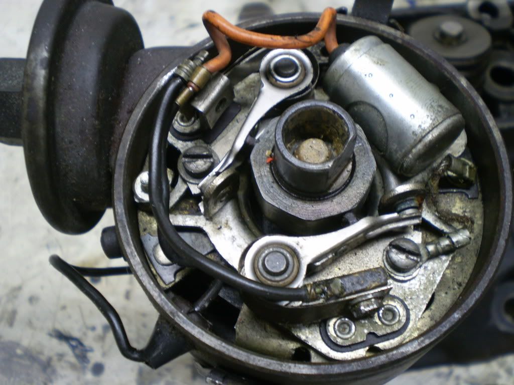

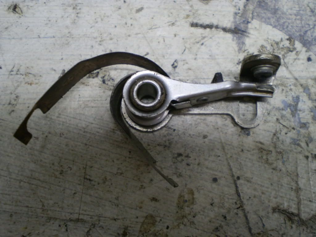

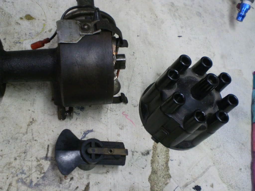

Hi folks,
I'm new to the forum and need some advice. I have a 67 barracuda formula S with 273 4V motor. It has a dual point distirbutor and I need to know what brand etc so I can buy points, cap, rotor, condensor and hopefully a vac pot. It has a small aluminium tag on the side which says "Chrysler" and the number 2642358 and at the bottom of the tag IBS4013B526. I have posted some photos, any help much appreciated as I'm in Australia and don't know what to ask for with the parts when I start looking for them in the US.
Thanks
Dave
If I recall correctly, the DP distributors used the same points and condensor as the SP distributors. Take the distributor to your parts store and match them to what they have for a SP distributor for that engine and year.
If I remember correctly, the dual point distributors were made by Prestolite. They also used different points than the single point. But as stated in the prior answer, take it to the local parts monger and match up the pieces.
The HP 273 distributors were made by Prestolite. I got tune up parts for mine at
NAPA. Last time I checked, Car Quest had parts too. toolmanmike
Thanks Guys
Mike at "Year One" got back to me today, they have the points, cap, condenser and rotor for this distributor ($60 all up). Yes, it's a Prestolite but it isn't as easy as walking into a parts dealer and asking for these parts as they wouldn't have a clue what a Barracuda was!!. It would be like me walking into a parts store in the US and asking for points to suit an FJ Holden, they would probably laugh at me?
Anyway, the only thing I have to find is a vacuum advance unit for this Prestolite distributor, waiting to here back from Year One, any ideas where else to get one or does someone have a good secondhand one ??
Thanks
Dave
If you can't find a new vacuum advance for that distributor, read up on advance curve. You'll find the engine can run just fine without it.
Leave it in place and plug the vacuum line going to it.
A "real" parts store can look them up by the distributor number, off the tag.
Those points / condenser/ cap/ etc should be the same as ANY Chrysler / Prestolite dual point used in the '60's--70's. They were used in 340s, 440 sixpacks, and hemis
Try telling 'em you have a '70 340
