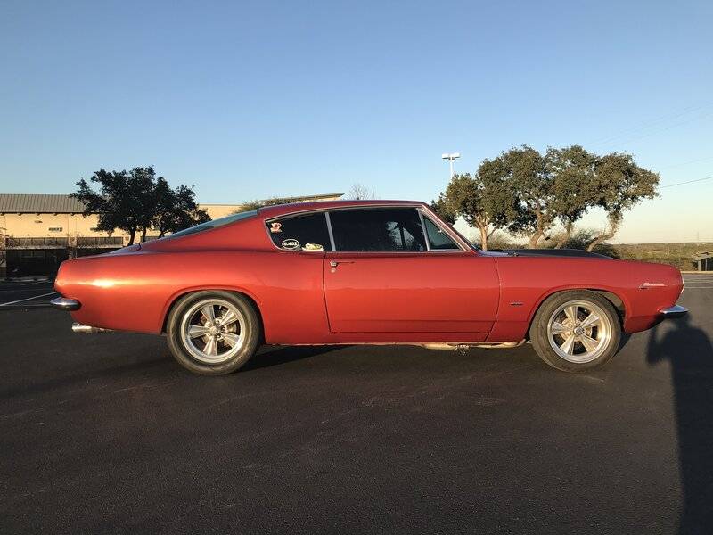

khuebner
18x9, 18x10 Toyo r888r 275/35/18 335/30/18

275/50/17 nito rear
215/50/17 front coopers
