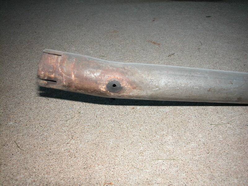

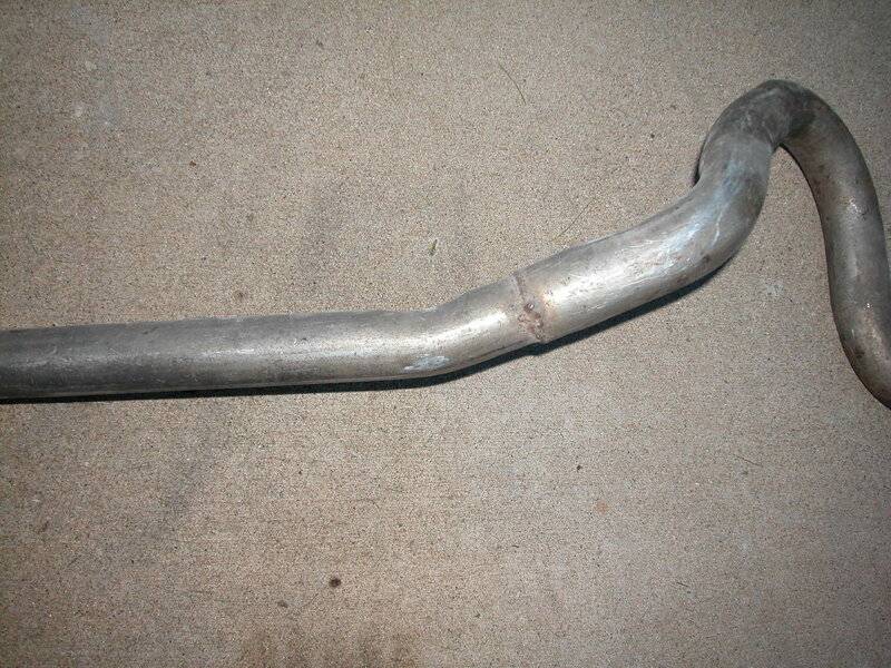

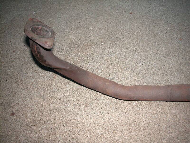

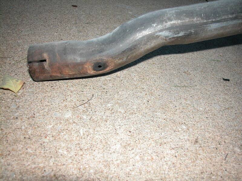

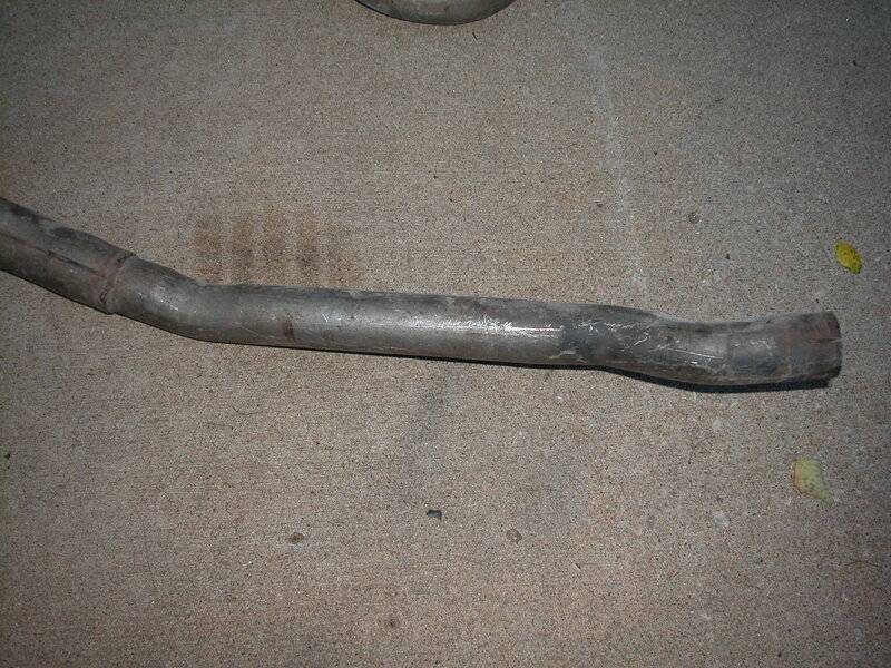

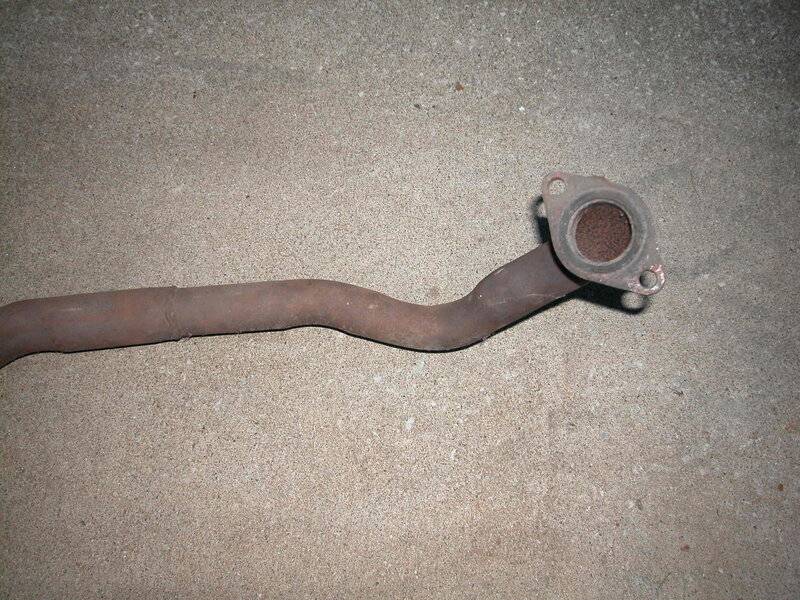

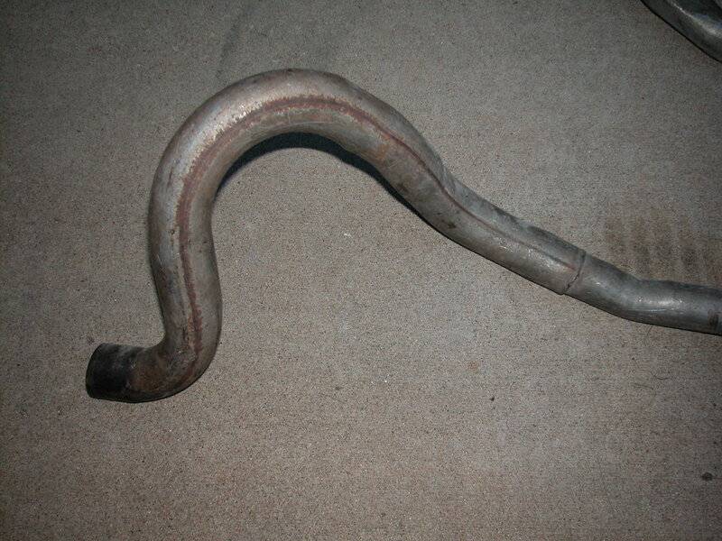

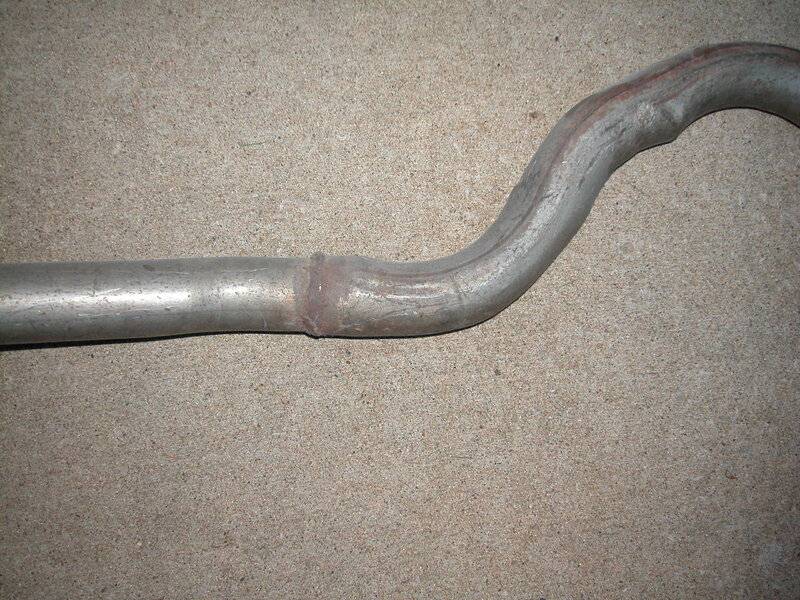

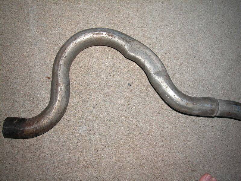

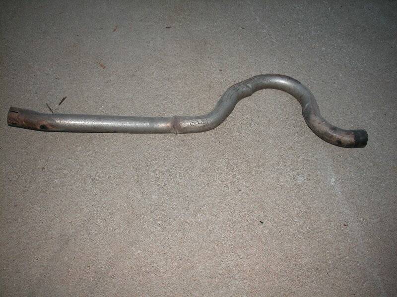

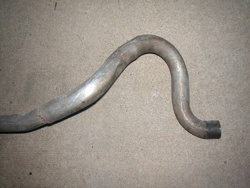

Here pictorially is what is being described. These are stock 69 340 factory tailpipes.
Hope these add to what the previous posters have explained. Front section is 2.25" OD and the 1.875" OD tips fit inside the tailpipes' outlet.

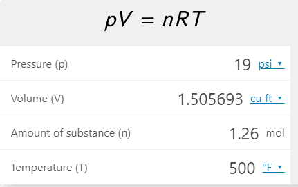

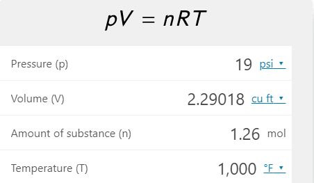

Please @VOETOM check over this... But here is my thinking.
When air temperature lowers it takes up less space. PV=nRT
Seems like EGT's near manifolds 1000 deg F. And tailpipes at 500 deg F.
So.... 34% drop in volume in ideal situation. But shouldn't be way far off from reality.
If volume goes down, you don't need as big of tailpipe as head pipe. At least that's what I'm thinking.
***I'm not sure if the psi I'm assuming is right. But the 34% ratio is the same IF the pressure is the same front to back. ***

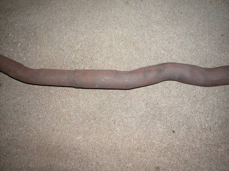

I still have the original exhaust on my Barracuda. I can take some pictures if you like

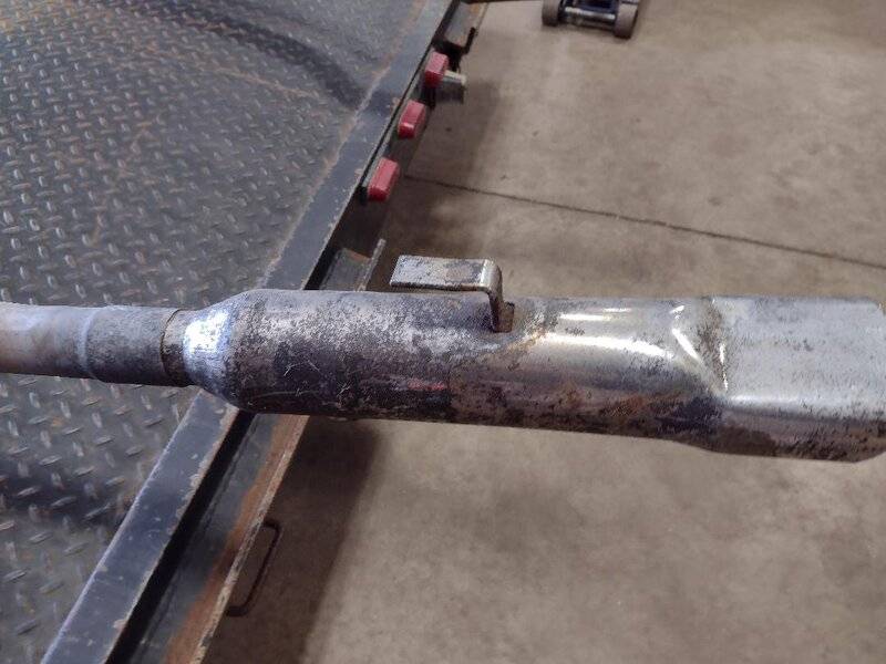

I forgot to also add you can tell they are factory pipes because of the hole in the low spot right before the reduction for the chrome tips. 340 Darts and Cudas in 69 had six water draining holes: two in mufflers, two in tailpipes, and two in the chrome tips.

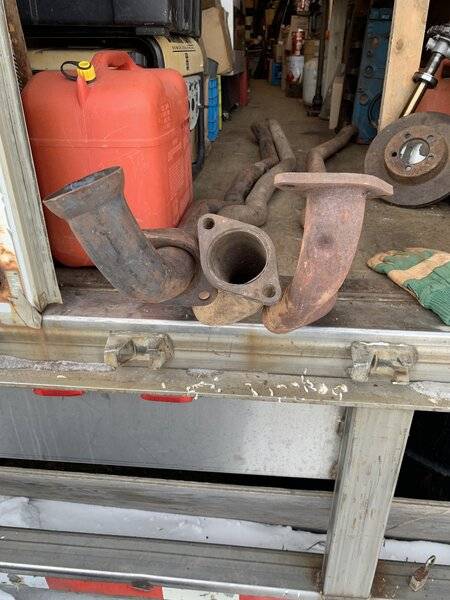

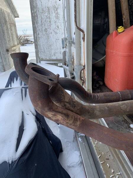

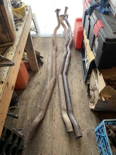

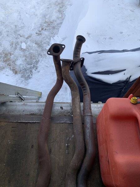

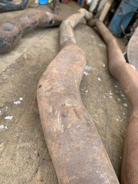

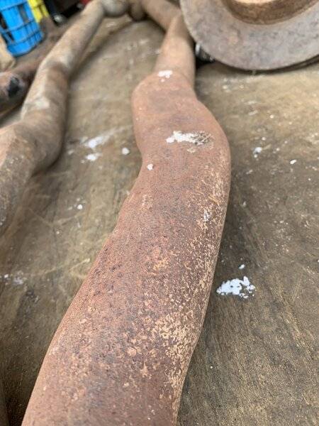

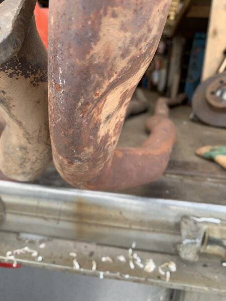

That’s right VOETOM. I had some posted for sale this winter. The 2 flanged pipes are from a 70 duster. Other bell pipe is 1971. Notice how the bottom of both pipes are flattened some. Kim
