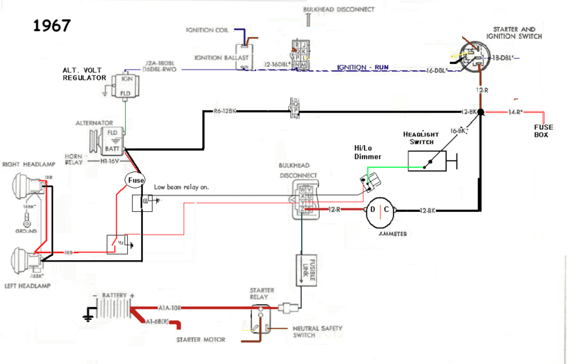

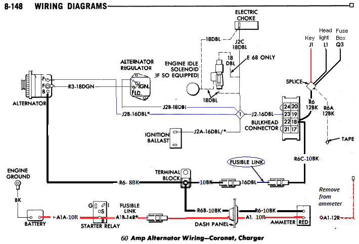

Ammeter when at idle sits at centre if not into decharge. When driving on highway ammeter goes into charge by 3/4 when flicking fan on, when I turn it off the ammeter goes to to 1/2 on the charge side. I’ve check the ground, harness has one field and other going to ignition. Does this mean the system is working properly?
Only on throttle the ammeter goes into charge but doesn’t pin to the end
