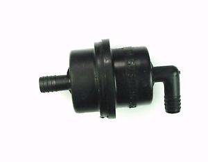

I installed a charcoal filter in the vacuum line from the intake to the booster to prevent gas fumes from deteriorating the rubber diaphragms.
Dorman part number 80195.
