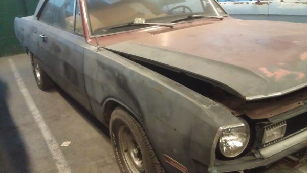

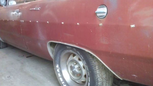

these are some pic's of it, the second one has the gt face plate just behind the door
Looks like the base for a Great Car! If you want the interior to look stock, you can get the high trim Bucket or bench interior the car came with from Legendary. Bench - order the 70 Dart Custom Bench stuff; Buckets - order the 70 Dart Swinger 340 stuff. all seats and the high end door and rear panels are available in black, two tone green and two tone blue. Good luck with the project!
thats one reason i like the car it has all the interior and most of the chrome, not that i like chrome but 85 to 90% of the car is there and from the pic's it looks straight
