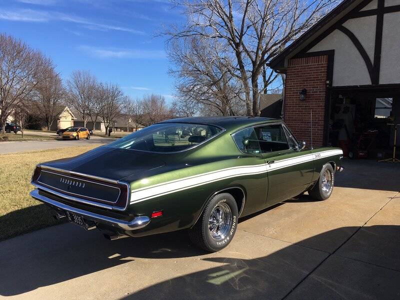

I have used Restoration Shop paint from TCP Global with excellent results. The F8 green I painted my Barracuda with sprayed and covered as well as any name brand paint I've ever used.. I used their Epoxy primer and 2020 clear also. Very happy with them. I would have tried their high build primer, but I like Evercoat G2 so much. Here is a link to their Plum Crazy basecoat. The can mix just about any color from any year. just select Paint and then Restoration Shop on their website. When you follow the link, you may have to re-add 1970 Dodge, Plum Crazy, 2210 for chip code and C7 for manufacturer's code.

View attachment 1715590113 View attachment 1715590114
NICE Green.
What color is the interior?
White would look good with the white stripe
NICE Green.
Thanks. The exterior is stock F8 Dark Green Metallic, and the interior is the stock Mopar Dark Metallic Green. Would you be able to see a white stripe on a white car? I've seen black stripes on a black car, and the only way (almost) you could see them was due to the different sheen. I saw a white 69 FB with red callout stripes and a red interior and red line tires That was a sharp looking car. I considered that combo when I restored my car the first time 26 years ago. I say first time, because after 15 years of driving it, it really needed a few dents fixed and some paint. So I just blew it completely apart and did it again in the same green/green colors.
