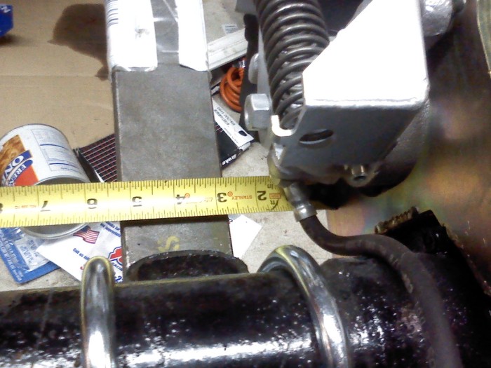

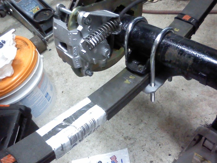

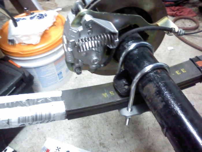

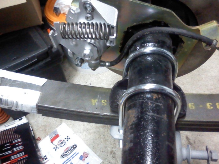

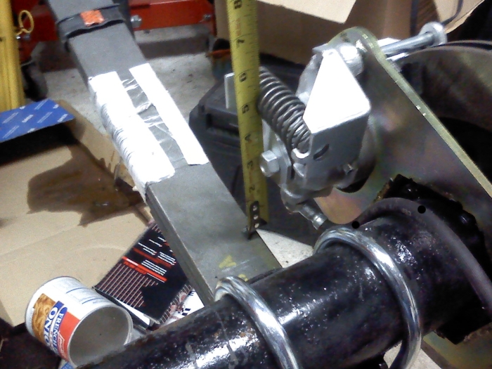

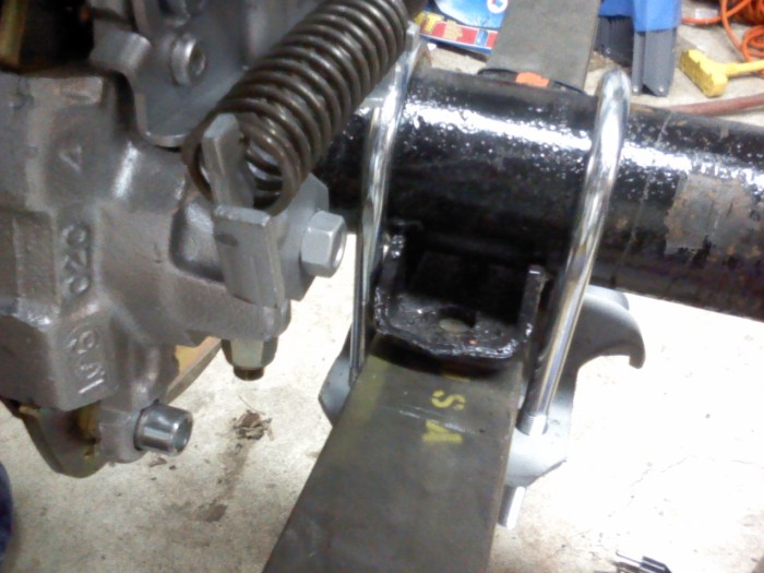

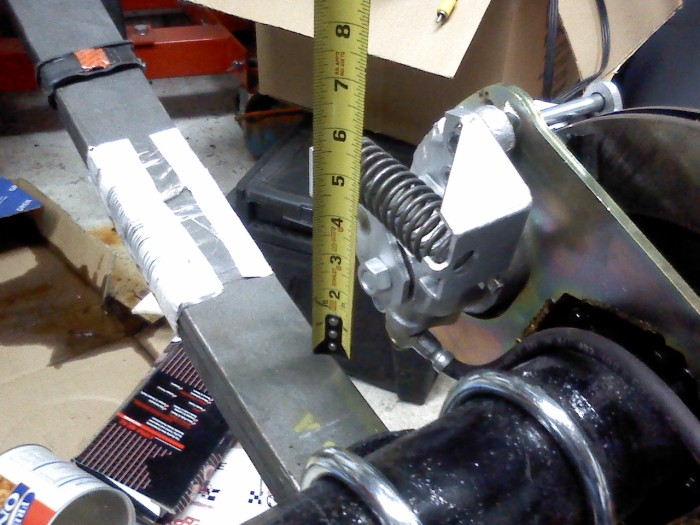

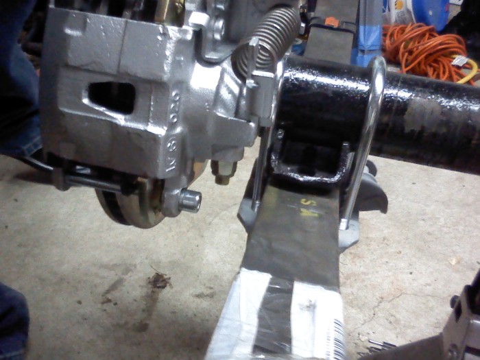

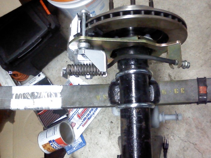

I have a couple email about spring fitment questions about springs hitting the calipers. There shouldn't be any issues with them. I took some pics so show the spring installed.
BTW I know the shackle is on wrong this is only for a reference. LOL!!!!8)
