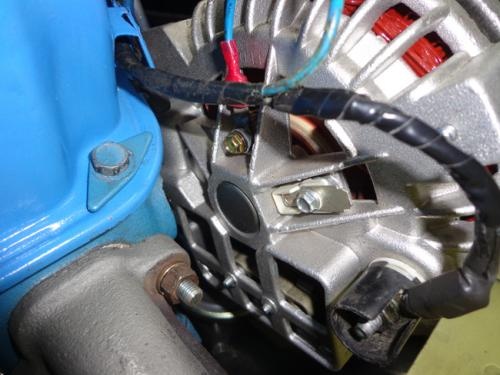

This is mind boggling! Turns out I have the square back alternator( see pic) on my 69 Dart 340 with one wire going to the term at the 12 position and one to the output terminal, and I have a VR that's a black box with a terminal ( IGN) on the bottome and a terminal ( field on the top and that's it. So what's wrong with this??? The guy I got the car from really mickey moused a lot of things so this doesn't surprise me!

Are you sayin it charges OK? Only one explanation if it does........the remaining brush holder has had the insulating washer removed and replaced with a metal washer
Remove the field wire and check for continuity from the field connection to ground. I bet it shows continuity.
If so, cut off that spade terminal so you don't accidently connect the field wire to the grounded one.
If it does NOT charge, ground that remaining field terminal
EDIT. Just saw your post in your other thread. That is troubling. 16V is too high as if the VR is not doing anything.
FIRST unhook the field wire and see if it stops charging. Check for continuity as I first said above.
Then see if the VR is mounted tight and grounded.

Again, sorry bout that. So how should it be hooked up?....this is the way it's been since I got the car a couple of months ago and it's always showed it charging , but lately it's been showing 16 volts on the voltmeter. The regulator is the "little black box" kind with one terminal ( field) up top and one terminal ( IGN) on the bottom.
OK, pay attention, LOL
1....the way it's hooked up now it should NOT be charging at all, WHY? Because the field winding has no connection.
2....The fact that the system IS charging means that either that field terminal is actually grounded because someone removed the insulator, or else
3....There is actually something wrong with the field, meaning it's internally shorted to ground
4....The fact that it runs up to 16V means either the voltage regulator is not actually in the circuit, or that it's not grounded, or that it is malfunctioning.
5...How to fix? Start by reading my previous post:
Once you have done the above, if it continues to run at too high voltage, check the power TO the VR. This is IMPORTANT. You must do this carefully and exactly
Hook one probe of your meter to the VR ignition terminal, or to the ignition power coming into the ignition ballast resistor. This is the power coming FROM the ignition switch.
Hook the remaining probe to the battery POSitive post. With key in "run" and engine stopped, post the reading. You are hoping for a very very low reading, the lower the better.
If this reading is .3V (3/10 of one volt) or less, replace the VR

Turns out that terminal that's not hooked up on the alternator is actually grounded. I dropped by a buddy's shop and he checked it out . The VR was one of the "non adjustable" digital ones and was faulty so we replaced it with an "adjustable" one and it seems to be fine, so far! Thanks a bunch for your help........and patience! :???:
Very good. I would cut that terminal off so you don't "make a mistake"
