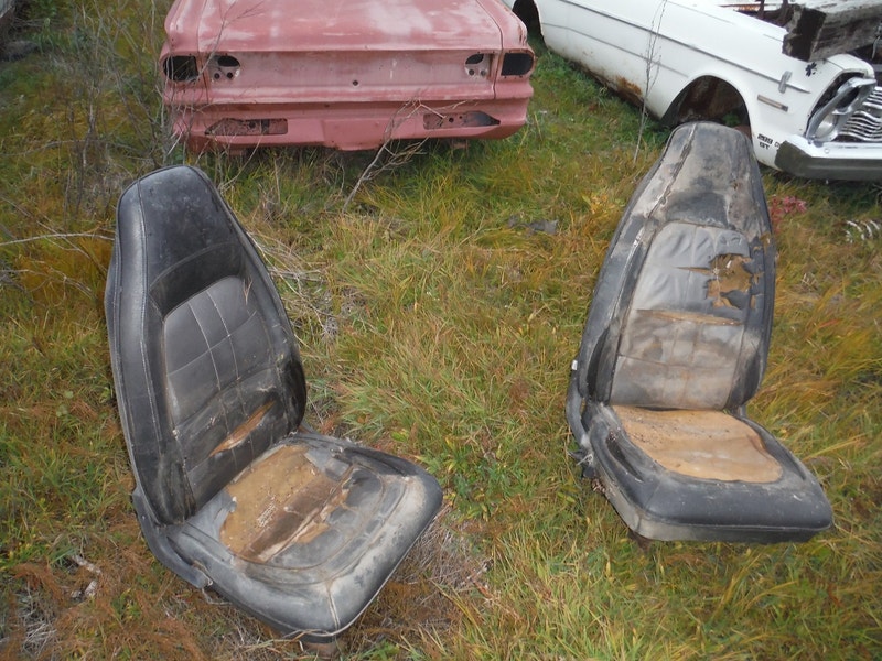

I just called Ron at Legendary n he told me I need 71 Duster Back seat frames. He says only 71 will do n have the springs attached to the frame, but he said my seats don’t look bad n they can be repaired. I’m seeing a few 71 buckets for sale n the price is getting to be a lot more than I want.
See attached pics of my 72 buckets n Ron says they can be fixed up.
So if anyone has seats in the same condition as I do then yours too are repairable .

Well I’ve googled n searched for hours. Looks like used 71 Duster bucket seat are expensive n not many left that anyone wants to sell. Only pair I saw was $800 n they were covered n I couldn’t see how good the frames were. So I might as well use my 72 seats n have them reupholstered. I’m going to use the correct coachman grain material n use black perforated carbon fiber inserts. Carbon fiber to match my Rally Dash n Center Console. I bought new overlays for my Rally Dash n Console from DMT Detroit Muscle Technology’s
