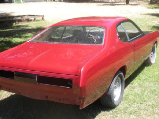

Also, Jeff liked the idea of doing something different with the taillight panel. I welded over the lock hole after we designed a lever and pull cable to open the latch. We used a cable and lever from a Subaru Legacy wagon.
The 72 Duster 340 had a decal on the taillight panel that spanned almost the entire panel. We liked the design used on the Demon models, so I masked and painted it to look like a mix of the two. The idea was to look like something that could have been stock. We have a decal that will be affixed in between the lights. It is the "Duster" tornado with the 2 eyes inside it.

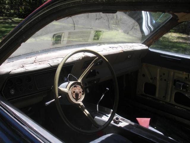

We have door panels, A pillar covers and other things, but still need carpet and a package tray.
Check out that D A S H P A D !!
