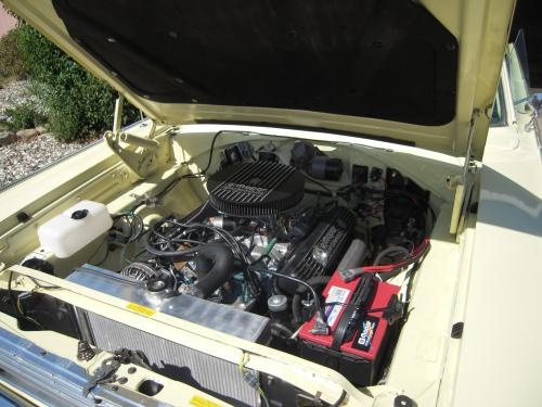

Hey TX...I am not really an A Body guy but love MOPARS. B Body for me. Looks like you are doing some great work there. We can make this 383 thing happen no doubt. Just as you said, need to get the logistics down but I can get it up to Chico no problem as the distance is really not that far. Long day trip. the 383 if you do take it is a great build for a non HP 383. Runs like a scalded Cat and will look really nice in your A Body. Hope to hear back from you on it. I PM'd you back so make sure to check that one out. What are your working there at Hickam. If you are a B-1 maintainer then you must be working In route for the Maintenance Group there I am guessing. Keep in touch and now that I am up to date on your builds and needs here on FABO, I will pop in to see the results. Check out FBBO as I am one of the regulars over there...cr8crshr/Bill
Hey Bill! Happy New Year, and that's a sharp lookin' ride. Believe it or not, the 383 will more likely end up in my Dad's '84 Ramcharger, but now that there will be two B engines available to me, there may be a 383 between the shocks on my Scamp too.
