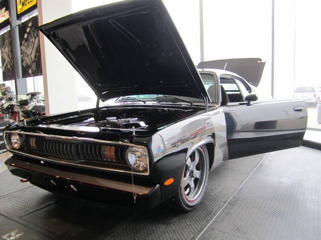

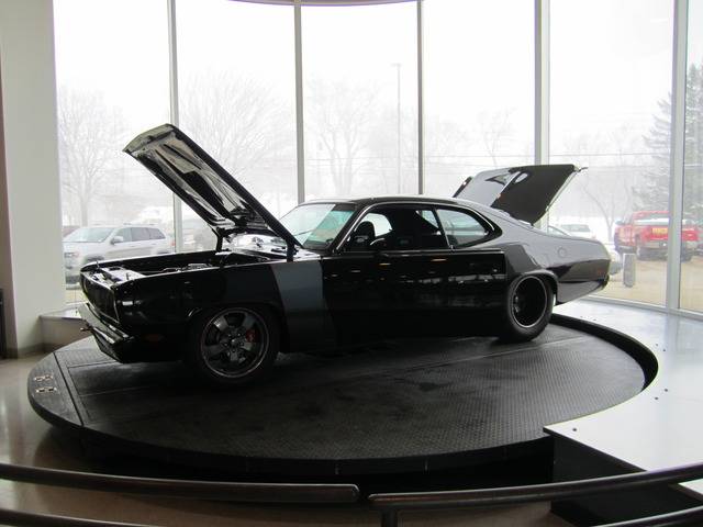

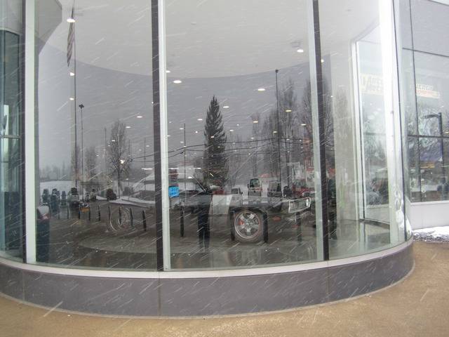

Imagine my surprise when we walked up to the entrance at Summit Racing's world headquarters!
Denny had kept this under his hat so that I could be surprised. On the turn table inside the front door
was Ross's Duster!

The Duster looks right at home on the entry stage at Summit.

Man this thing would give a jellyfish a hardon
Thanks..... that an interesting description, I like it !! I talked to the guy in charge of the displays at Summit Racing yesterday he said he's gotten a lot of questions and comments on the car since it's been on the turntable.

Not pissing in youre pocket but the stance the color the wheels is all perfect I wouldnt change a thing,man I wish my aussie A body would look this staunch ,shes like the hot curvy chick in the tight jeans.
You could get your Aussie A body the same stance with a few couple easy steps.
1. Install a full wheel tub ...you have to get rid of the outer part of the wheel well to drop the body down that low if you want a tire that tall (No mini tubing) .
2. Install a custom made HDK suspension...by custom I mean one designed to raise your motor for more ground clearance, mine is raised 1 inch. Also, convert the rear suspension to a coil over type suspension.
3. Raise your inner fenders for tire clearance and your transmission/driveshaft tunnel for driveline clearance, I went 1.5 inches on everything.
There you go easy as 1,2,3.......
