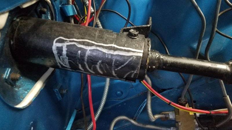

Hey 408 Swinger, I just took this picture. Regarding the cover of the steering hitting the valve cover, do you think the area I marked with a silver sharpie will get the job done? From your photo, it looks like you cut the whole thing off? Thanks for the help!
You're pretty dang close. Probably gonna need a little more. I did go back pretty much flush with firewall. I cut grooves back into the tube to hold the snap ring that retains the lower bushing.
