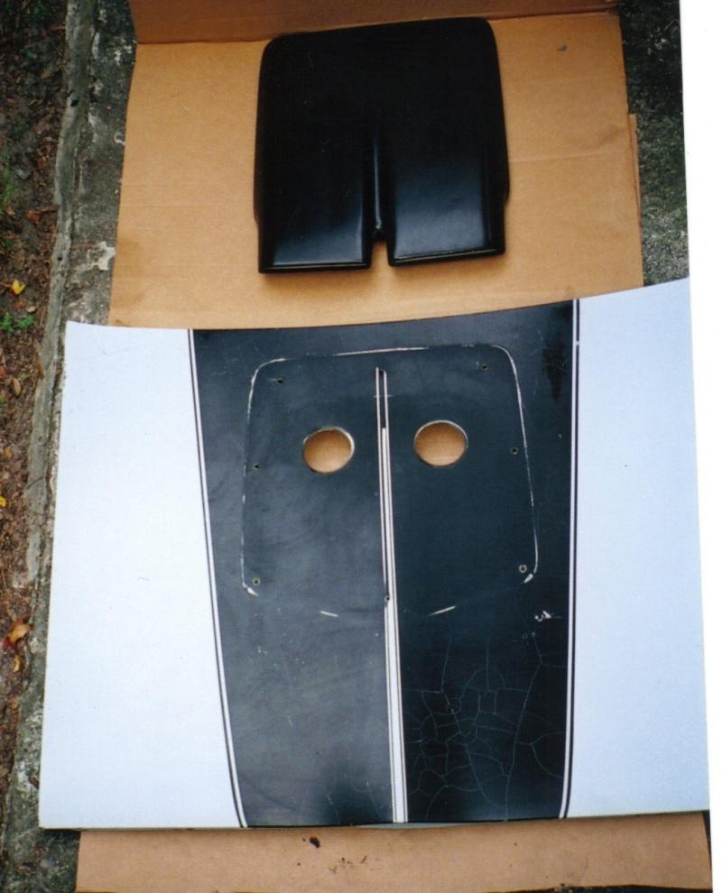

attachment.php

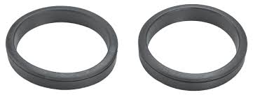

Darter6, this is the factory holes that came in the hoods with the double snorkel hood scoops. they are 4 inches in diameter and DID NOT have a fresh air seal made into the air cleaner. they only had seals that went around the edge of the holes, and had lips that stuck up so rain would not blow into the holes.
this is the seals. I think year one has them.
that should be what will be legal if you use the scoop on the duster.
dad set me straight on the bezels. he said they were indeed open and not fully closed off. he said I was thinking about the ones on a 67 GTX. I found the ones he had. here they are. only difference is that the edges of his were chrome. sorry for causing any confusion.
Thanks to all, 71gtdart, the photo in post #13 is what we are looking at doing. I didn't think that they ever sealed to the air cleaner on A bodies ,Thanks guys for the info.
