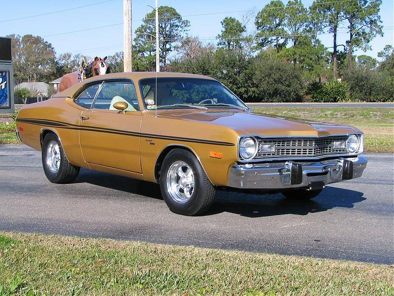

I Have The Stock Rallys With Good Year Polglass Tires E-70-14 Plus I Mostly Run American Racing Torque Thrust, Rears Are 15x7" Wide I Think A 4" Backspace With A 275-60-15 T/a Radial, They Fit Great, Have About 3/4" Clearence Between Tire & Leaf Spring. The Fronts Are 14"x5 2 1/2" Backspace With A 215-75-14.. Hope This Helps
The fronts can be very tricky on A-bodies in my experience. Heck the rears are no picnic either I suppose.
A lot of it depends on how low the suspension sits you your car.
Look at the photos of the Dart Sport above. The front tires work well for him, however with the torsion bars lowered a bit like on my car you couldn't turn at all without those tall front tires rubbing hard on the fenders.
BTW that car Dart Sport above is absolutely gorgeous!
