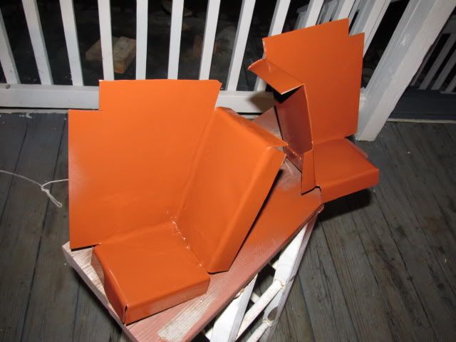

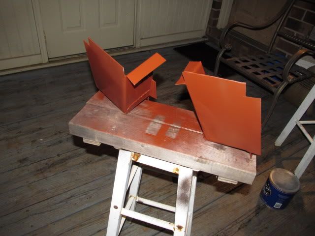

My next step now is to start repairing some body rust. I mentioned earlier, that the previous owner just painted over a buncha rust, bondoed over it too, and generally did a damned jacklegged job on the body of the car. The scariest part though, is the rear leaf spring mounts. Actually, not the mounts themselves, as the sheet metal box they bolt to. The one on the driver side is GONE, and the spring rests against the floor of the trunk. The one on the passenger side isn't to that point yet, but it's getting there. It's a good thing too, that's where I got all my measurements.
These are the replacements I made in my welding class, they're 14 gauge steel (thicker than what they're replacing btw) and I hit them with some red oxide primer to keep them from rusting. I'm pleased with how they came out, but I'll say one thing for sure, this project had me come up with a new song: "I wanna box brake for christmas!" (sung to the tune of "I wanna hippopotamus for christmas.")
