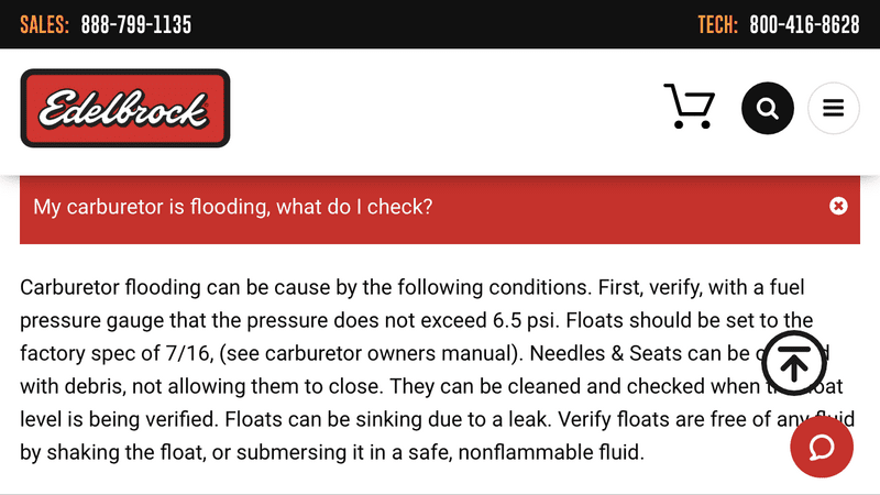

Not one Edelbrock carb I’ve ever seen has liked excessive fuel pressure. Holleys, yea they can take a little more but the Ebrocks blow the needles off the seats pretty easy in my experience. I’ve tuned a few and always the first thing I do now is set the floats correctly (even if brand new), and make sure it has no more than 5.5psi of fuel pressure. That’s step one.

Don't care what Edel says, the AFB/AVS carbs will take a LOT more pressure than 5.5 psi. What more pressure does is raise the fuel level slightly, which might be what Edel is warning against. Flooding on AFB?AVS/TQ carbs is not a problem [ within reason ] because of the high leverage of the float assy. I have run 10 psi at the track to raise fuel level, never a hint of flooding.
Plus, the E carbs come with a tiny 0.0935" n/seat. In contrast, the Carter Comp series AFBs had 0.101" needles & seats. The smaller size can handle more pressure before it is overcome with excessive pressure. The Carter mech strip pump M4862 for BB Mopars is rated at 8.5 psi. Street pump M6903 is 6 psi.
Carter calls for different float height settings for different needle and seat sizes. Float height setting affects primary booster flow simply because a higher float height setting places the fuel closer to the booster outlet.
I do not understand how Edel arrived at the 7/16" float setting. The Edel AFB body casting is the same basic casting as the Carter AFB, yet some AFBs had float settings as high as 3/16". Which makes the Edel setting a full 1/4" lower & that is huge with float settings; plus, the E carbs use the tiny 0.0935" n/s, which keeps the fuel level even lower. I often wonder how many 750/800 Edel AFB/AVS carbs that performed poorly on the top end was simply because of insufficient fuel supply.
