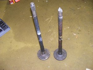

pettybludart Well-Known Member Joined Jul 18, 2008 Messages 15,311 Reaction score 291 Location Ontario,Canada Nov 2, 2009 #10 Here,s what happens when you launch with slicks and 450hp with a 4 speed.With the 8 1/4 I,m lucky I had no damage to the car.Lesson learned,go 8 3/4 or Dana S60.Good Luck!
