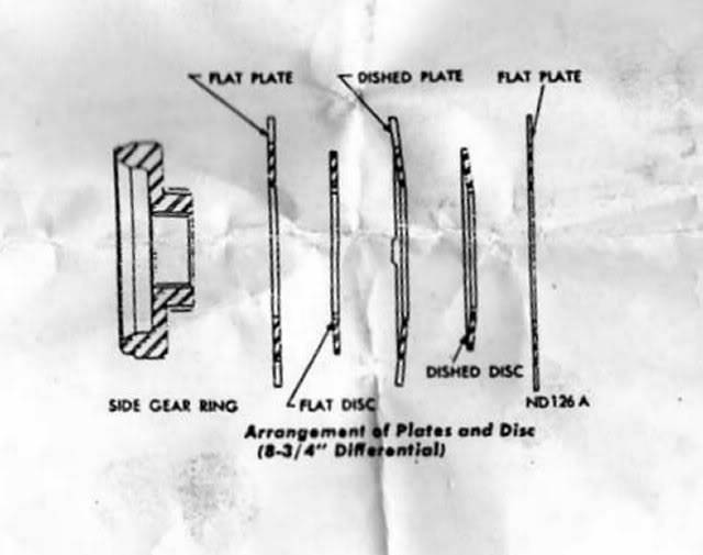

Here's what I have saved.
yes ,, the above pic shows the correct stack for the factory stock clutch pack disc's showing 2 dished plates --giving an average preload of 200 ft/lbs in a stock factory power lock.---- replacement clutch pack Mopar Performance P4529484 has the identical number and shaped disc's giving an average 200 ft/lbs rotating torque in a stock factory power lock.
the new aftermarket powerlock unit i purchased-- --has the same number of plates and discs but replaces the second from right dished disc with a another flat disc and a thicker tabbed end plate giving an average of 90 ft/lbs rotating torque.---- the case halves are also machined an average of .020 - .030 deeper than the factory cases.

The 1957 to 1964 units had all flat plates/ discs. 0 preload. They work perfectly fine. And if u spin 1 tire forewards the other rotates backwards giving u the impression it’s an open diff or a ruined 1. Kim
