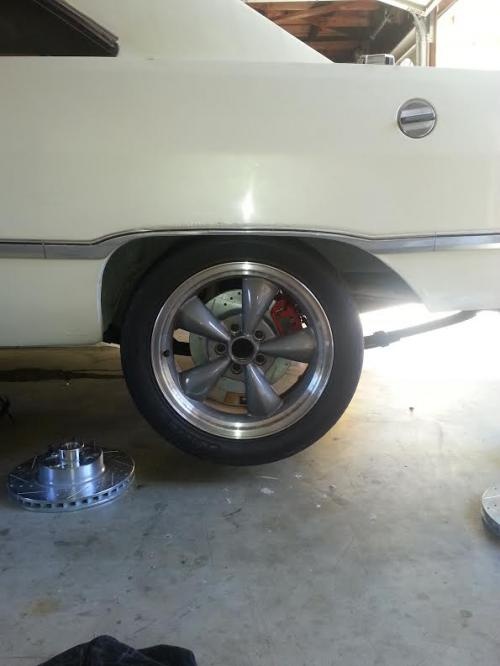

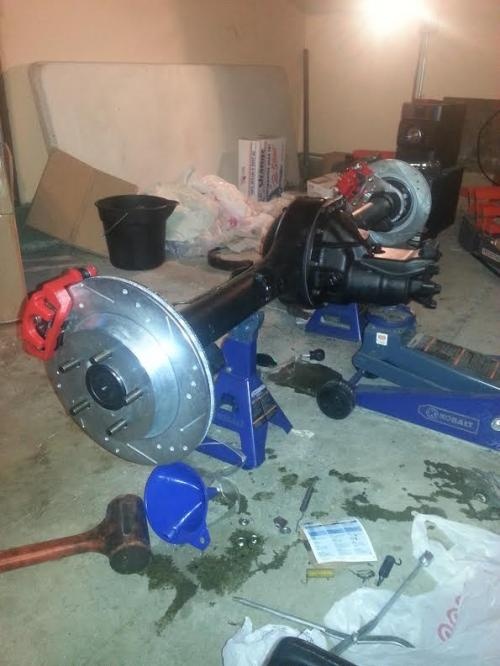

If you want to go with disc brakes, don't even bother with the drums as you'll have to take off the axles anyways to install the new brake kit. I installed Dr Diffs axles and 11.7" brake kit and it went together really well. Car is still not running but I've always liked Dr Diff's parts.

Thats a neat rear disc swap, but I want to keep the drums in the back and will go with disc in the front. Wanting to keep 14's and old school 60s/70s school.
