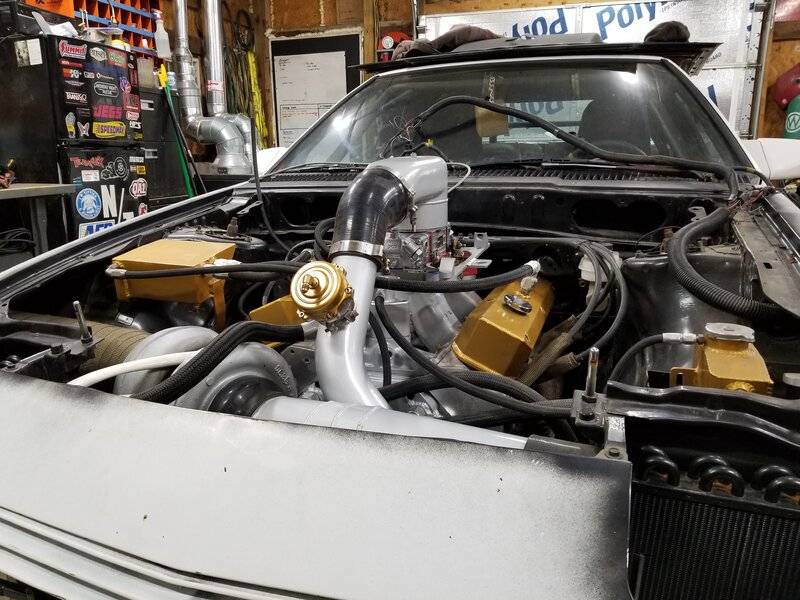

Had some time tonight waiting on a customer to pick up some parts so i was able to get the fuel pumps mounted. Welded some flanges on the mount i made a while back and drilled some holes into the bottom of the fuel cell frame.
Little update:
Made a bracket and welded it to the car for the pump for the meth injection and got the meth tank plumbed to the pump.

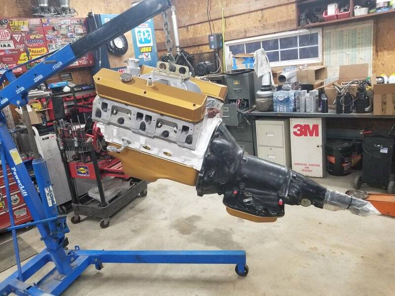

Transmissions are rebuilt, one of them is in the wifes car, the other is waiting for me to finish the turbo motor. I have a short block assembled, just have to get a set of heads.

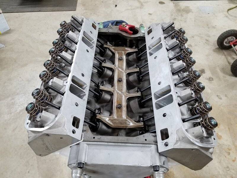

I finally wrapped up the porting on my heads, they are now getting a valve job done, then i will be setting up valvetrain geometry, and final assembly of the engine. Plan to stick everything back into the car after the holidays.

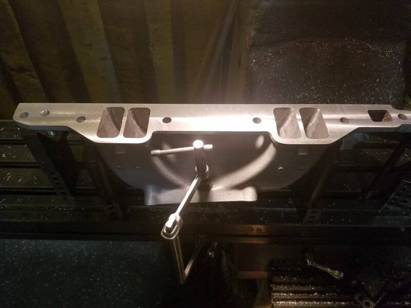

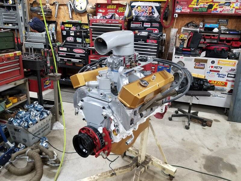

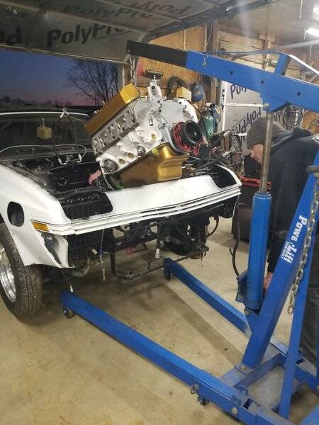

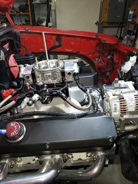

Made some more progress finally. Got my b3 kit in, pushrods ordered, final clearance on the heads, milled the intake for proper alignment, assembled the motor and put it in the car for good. Next up is plumbing and wiring.
is there a benefit to that, or is that just what you had on hand?
Car and engine are looking great. Are you going to be useing the factory magnum Alternator?
yes, ill have to make a bracket to mount it off the drivers side head.
Sorry I wasn't sure if you was useing the factory magnum belt set up or not. Because if you was the magnum Alternator will not clear those valve covers with out some massaging. I had mod mine to get the alt Battery + terminal enough room to clear the valve cover. Still ended up also having to cut the 12V terminal down.
