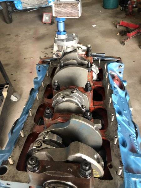

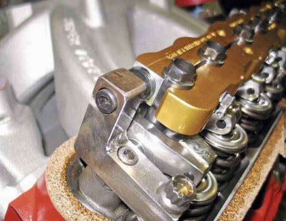

11.70s In the quarter 7.40s in the eighth on the motor.
6.80s-6.90 with a 150 shot. thousands of passes with nitrous which I only used on 1/8 mile tracks spinning hard.
If I had to shift my stuff at 9000 rpm to run 11.70’s I would buy a camera and put and LS engine in it. Sorry but there is not excuse for doing that.
Stock 273 block 8 sleeves and 3.75 bore for 292 cubic inches
Stock crank
5.4 H-beam Ford rods with EDM pin oiling
Diamond custom pistons with crappy 1/16 ring package
Wet sump oil pan and HV pump with oil crossover
Iron magnum style engine quest heads w/roller rockers, jomar girdles and pushrod oiling
Comp solid roller cam and lifters
Lots better parts today to make way more power
View attachment 1715429420 View attachment 1715429421
This is all too familiar. There is a picture of a 292ci 273 engine with 8 sleeves taken in 2010. It has Indy/RHS-X heads, Jomar girdle, stock crank, Ford rods, roller rockers, push rod oiling, Comp solid roller cam and lifters, wet sump oil pan, HV pump, oil crossover (hidden by the paper towels). I had to drive from Morton, IL to Melling to pick up the sleeves and bring them back to be installed. It had to be re-sleeved because the first set of sleeves were offset and the valves hit the cylinder walls.
The cylinder head had to be repaired because the #7 exhaust port cracked and was leaking water during the dyno runs. I had three of these heads that had the #2 or #7 exhaust port with very thin casting in spots.
See post 109 in this thread.....I believe this may be 273 engine from those dyno sheets.

That’s it. I always wondered what became of those heads!
Similar power per cube. That valvetrain was interesting to say the least.
It takes a rebel to take a shaft rocker mount cylinder head and turn it into a stud rocker mount cylinder head.
You know, if we had run that engine with the head leaking water, it still would have won the dyno contest. Just fire it up and make the three qualifying pulls without shutting it off and then made the three scored pulls without shutting it off, and we had a winner.
Agreed on both statements! Hindsight is 20/20!
