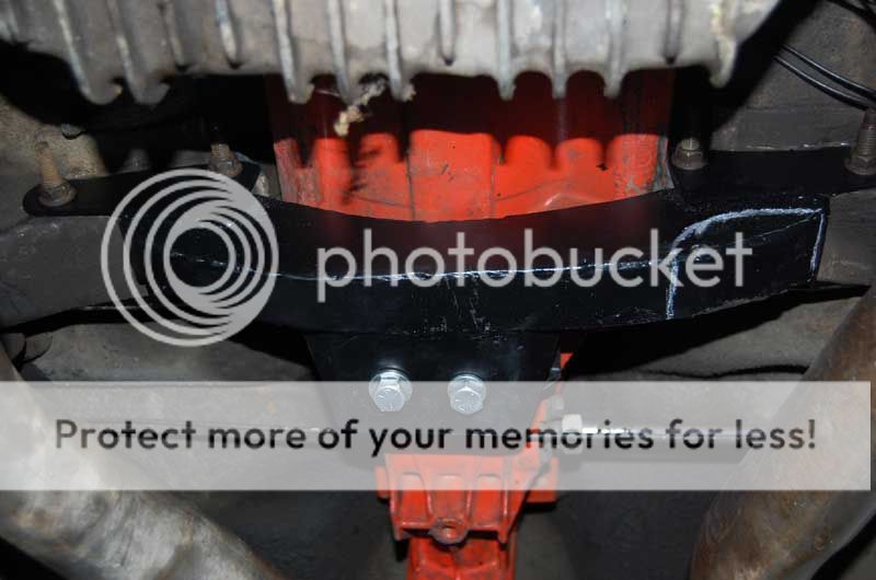

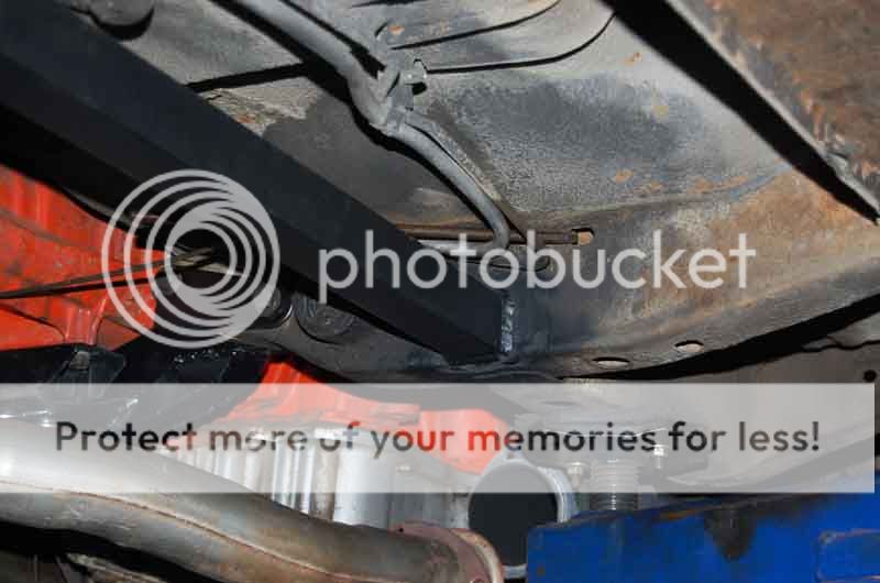

I have a 518 lockup that is waiting to go in my Aspen. How much floor work was required to get yours in?
None of the sheet metal was cut out. However, the hoop that ties the two torsion bar boxes together was cut out. It was replaced a plate steel strap that welded to both sides, the floor of the trans tunnel, and was beefed up with the trans mount. 2x2" subframe connectors were also welded in stiffen everything up.

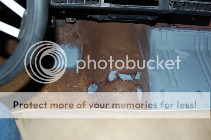

Dont' mind the floor pan replacement. The old evaporator drain leaked on the floor long before I bought the car.
Nice! I have seen some other earlier a bodies done that had the trans crossmember done along with the floor where the crossmember bolts
To. My f body looks like it will be about the same amount of work.
