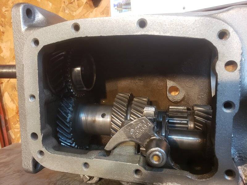

Planned on Assembling this tonight but...
Tried to set the 16 Needle Bearings in the Input Shaft and They Won't Go!
With 15 in I have a gap, the last one Won't Drop in!
I got my rebuild kit from Jamie Passon, So far Everything has fit flawlessly!
What am I doing wrong or missing? Hard for me to believe that he would send Oversized Bearings for this in Both Kits that I recently bought...
Well This Build Isn't happening, not tonight anyway
Thoughts?.

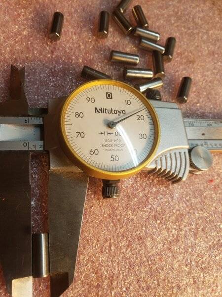

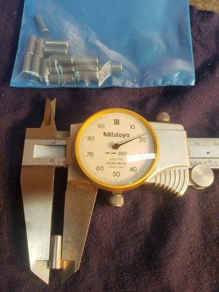

Do you have one of the old rollers to measure the diameter?
Yup! They're .217
I bet that One thousanth difference would give me the .016 that I need to drop them in!

I just measured a used one out of my 1965 a833 and it is .218. Same as my new ones from Passon.

My Old ones dropped right in... They're each One thousanth smaller than the ones from Passon
