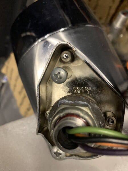

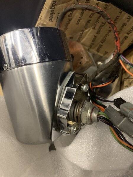

Just for ***** and giggles, here's an A body console tach mounting setup...
...and, no, B bodies just use the white plastic gasket.
Yep that's what I reproduce in aluminum or stainless steel and the plastic detent plate.
