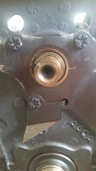

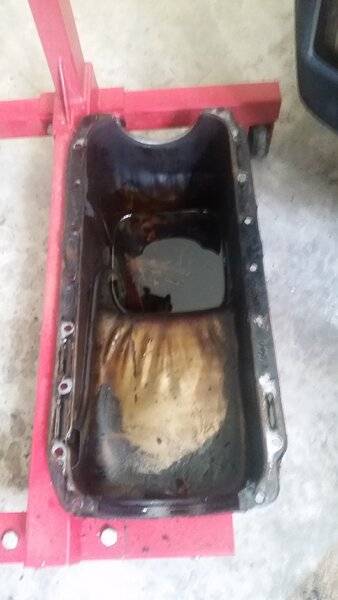

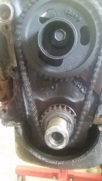

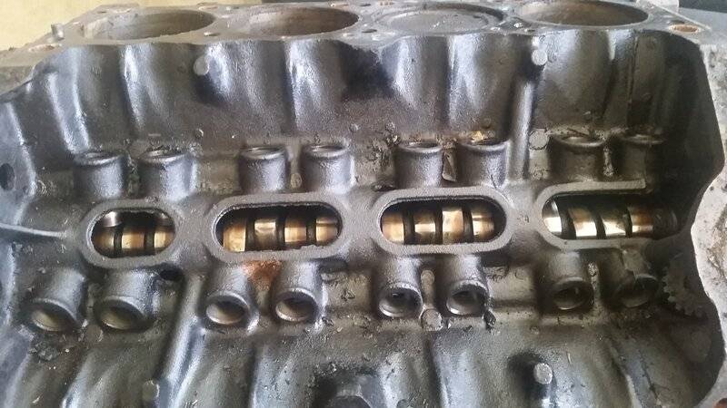

Been working from home since today last year.... took my lunch hour in the garage and pulled the front and the pan. Found it has a double roller chain, no oil hole drilled thru the top left cam plate bolt, no scrap metal in the pan. Tops of the pistons/cylinders carboned up a bit, but over all not too bad for a motor that looks to have been run too rich for too long.

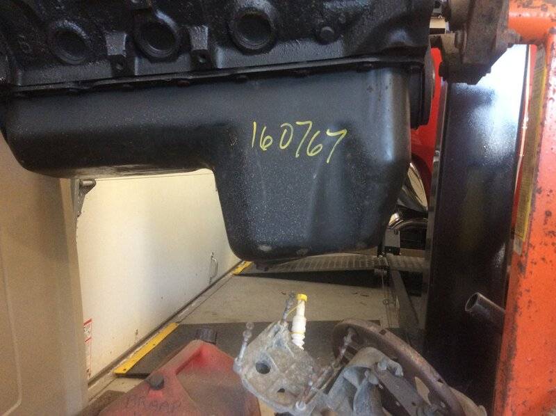

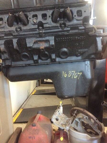

This is the pan I’ve got. Looks like the full sized truck pan. It’s here if it’ll work for you but it’s def not the top Durango Dakota fate is showing us.

I'll give you an E for effort and a nod of appreciation. That's the same pan I've got that came on my motor. The sump well is about 3 and a half inches to big front to back.

Btw, the lifters all popped out rather nicely.
Hahaaa.. ty..I’ll def try harder. Bummer.
View attachment 1715708042 View attachment 1715708046 View attachment 1715708047 View attachment 1715708048 View attachment 1715708051 View attachment 1715708052 View attachment 1715708053
They stopped drilling the hole in the bolt because it does nothing. A waste of time and effort.

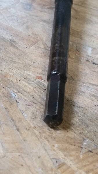

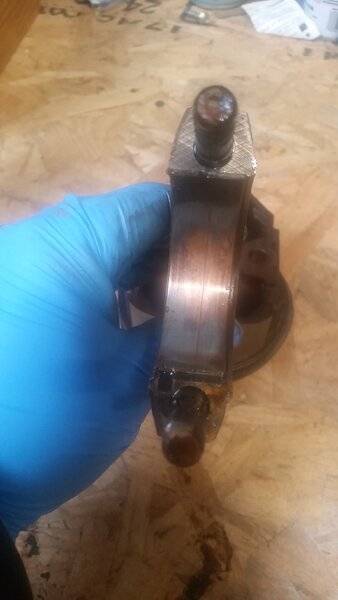

So in this 84, I found the side of the rods/caps already number stamped 1-8 like they were in 71 except they ARE in the correct order. Got them all pushed out past the carbon ridge without getting hung up. Standard size bearings that don't look too bad for unknown mileage. And the end of the oil pump drive is barely worn.
I wouldn't say it does nothing. If you have the drilled bolt in place, it does dribble oil down the oil pointer and onto the chain, so it does supply a little oil. But you're right for the most part. I would much rather drill a hole through the cam thrust plate and get pressurized oil there. I drilled a 1/16" hole through the oil galley plug in the slant six I just put together. It will blast oil all over the back of the cam gear.

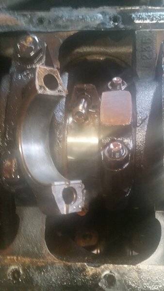

Just spent a whole 15 minutes and knocked the main caps off and lifted the crank out. 1st impression is it looks pretty dang good. Haven't inspected it yet other than a visual.
