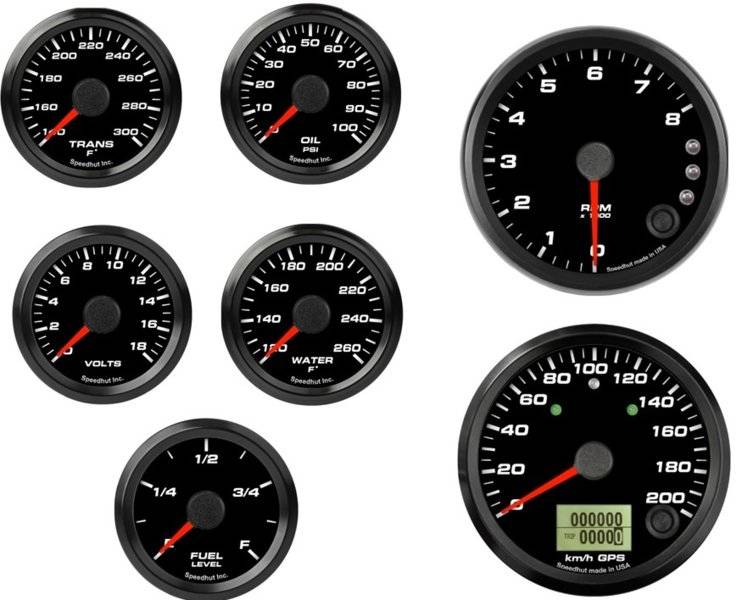

Speedhut, excellent product and you can build them online on their website! Just what you need while in isolation.

I put Speedhut gauges in my Duster last winter and absolutely love them.
Including:
GPS Speedometer - 100% accurate all the time. Integrated LEDs for HiBeam and Turn signals on face. LCD Display scrolls through 0-60 time/distance, 1/4 mile time and trap speed, Odometer, Elevation, Top Speed and numerous other things. In Canada so mine reads in Kmh.
Tach - Programmable shift lights on face, with output for external shift light
Fuel - I calibrated mine so that 'E' means 10 liters left in the tank. Wickedly accurate (with aftermarket sender) at any level in the tank. Easily the most accurate gas gauge of any vehicle I've ever owned.
I bought the special crimper and wired my guage cluster up with Molex Connectors to connect it all to the stock dash wiring nice and neat.
