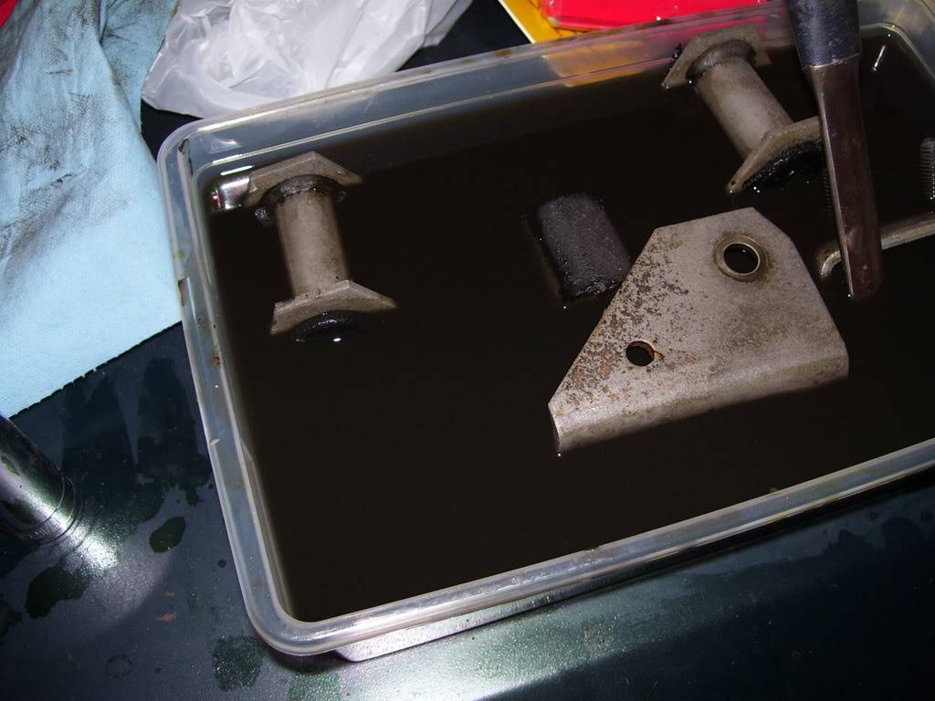

I bought a gallon of Eastwood's Rust Dissolver and I gave it a try I have had some parts soaking for 24 hours. I have to say I am EXTREMELY impressed. My parts were 38 year old rusty suspension pieces, they look like new now. Here are some pictures.
This product works great for anything that can be soaked in it, I submerged heavily rusted suspension pieces, it removed paint, grease, rust and dirt. The parts came out beautiful. This stuff only works on parts that can be completely submerged. Don't beleive the directions, it takes a few days to remove rust from heavily rusted pieces, not minutes and hours like the directions say. Also, forget the quart, forget the gallon, buy 3-4 gallons and keep it in a 5 gallon bucket, Its just easier than having to turn the pieces every few hours. Also, I rinsed the bolts with water and they flash rusted while drying. I am going to dip them again and this time spray them in WD40.
I recently found out that Evapo-Rust is the same as the Eastwood product, but a whole lot cheaper, it is available in a 5 gallon, which I recently bought for $70 plus $26 shipping. This stuff work great, it has been used by engine shops and the military for derusting without removing any extra metal.
Also, ckeck out the pinion snubber, I left it half dipped overnight, amazing difference.
Muriatic acid will work as well or better and it's cheaper plus easier to get.

The only problem is that acid removes metal, this stuff pulls out the rust without cutting any metal. Here are some better pictures of before and after of my parts. check out the first picture, I dipped about an inch to see the difference, check out how thick the rust was. Look at all the stamping marks, metal curls, and the rubber parts, acid would have destroyed the rubber and erased all the fine detail. The stuff also has some detergent qualities too, look at the rubber, it looks almost new, and now you can see the part number on the snubber.
I'm not saying that the other methods don't work, but this stuff is super delicate and absolutely eliminates rust without damaging metal while being safe for anything else attached to it. I have had some lug nuts that I left in it for 2 months and they are fine. That would not have been the case with acid or electrolysis based removers.

Actually I am now using EVAPO-RUST Instead, its the same stuff, but a whole lot cheaper when buying in a 5 gallon jug, It cost me $91 shipped to my door. ($65 + $26 S&H). I bought 2 gallons of the Eastwood stuff, but found out that Evapo-Rust is the same stuff and cheaper. I have bught 7 gallons so far, the stuff is bio-degradable and sewerable, I have had my hands in it many times, no problems, and it really does work. I keep looking for stuff to clean because its so much fun to pull out a perfectly clean part. (I know, I'm easily amused) Right now I have a set of Big-block heads soaking in a 5 gallon bucket. The only thing that was a bit of a lie was length of time, It takes about a week for heavily scaled and rusted pieces. The spring perches you saw tokk 4 days to derust, the snubber took about 2 days.

I tried the Molassis method, it works, barely. I tried de-rusting some spring hangers, i left them in for two weeks, it took a little rust off, but I would guestimate only about 1/3 of it. I decided I could not wait anymore, so I dunked it in Evaporust, it only took 3 hours to finish it off. I next tried it on an old rusty, chrome wheel cap, it worked a lot better on chromed or lightly rusted parts. Oh, by the way, did I mention that the molassis stuff smelly like a hundred dirty whores in my garage! :vom:
