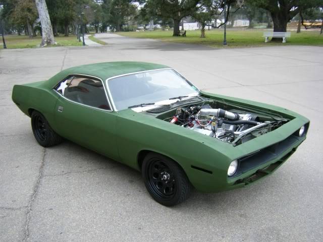

View attachment 1715964901 View attachment 1715964902 View attachment 1715964903
Impressive numbers. Hey "8.5/1 compression"

It’s 100% doable and I’ve done it. And I am currently doing it. Two things have to happen. You have to have a fuel with enough octane. PERIOD. I recommend e85. And you have to have your tune up spot on. At 5000 ft elevation there will be a little larger tuning window. 8.5:1 and 20 psi is no different than 10.5:1 and 5psi. Cylinder pressure is cylinder pressure I don’t care how you get there. As you go up in compression the tuning window gets tighter and tighter and the engine becomes more rowdy. If the ring gaps are tight now don’t even think about boost. 4psi at 10.3:1 will make enough heat (especially with a supercharger) to stick a ring and break the ring land. One more thing, intercooling is not an option it’s a necessity. Good luck.
1971 360 block. Hughes Engines main girdle, bushed lifter bores, bored .030”. Forged K1 crank and forged rods. 228/224 @.050 cam with 114 LSA. Custom forged Diamond Racing pistons. 8.5:1 compression. Hydraulic roller lifters and roller rockers. Hughes ported Edelbrock heads, super Victor intake. 750 Holley blow through carb. 1-7/8” headers, …
Beautiful street manners and it goes like hell.
650hp / 600lbft
My problem was not having the boost referenced timing retard and the water/meth system not being reliable. Right now it is sitting (7-8 years) and needs to be freshened. I have a new Snow water/methanol kit and an MSD 6 Programmable box with MAF sensor to sense boost. New game won’t pan for ignition and boost cooling.
My suggestion to you is to buy the fuel system and set it up and tune it to your current engine. Next, find a new block and start collecting parts for a new short block . You will need a forged rotating assembly, use your heads, use a single plane. Get everything switched over and tune the ECU for boost. Also, if you can fit it use an intercooler. I would but I don’t have room on the front of my E-body ‘cuda.
that car is bad ***.
