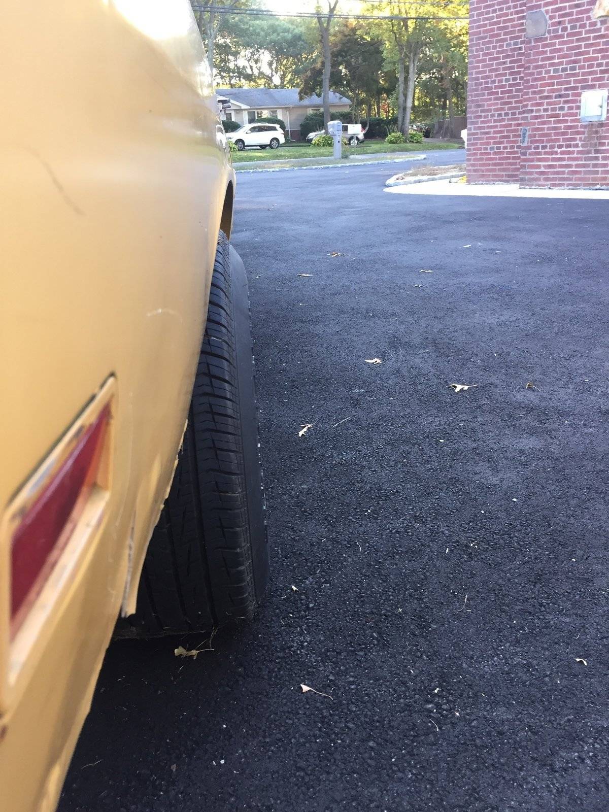

Your car, none of my business but i would leave the stock wheels on over those outlaw wheels. 15x8 with a 4.5" backspace with a 275/60/15 will clear and fit the wheel well nice with no issues on the the rear. Front go 15x6 with a 207/70/15 i have that combo on my 71 duster.
Can you post a Pic if what that looks like??
QUOTE="rumblefish360, post: 1971427984, member: 1189"]Me?
The plan is factory wheels and dog dish caps and trim rings.[/QUOTE]
After looking at Rumble fish's car you will need more than 4" backspacing on the rear. Best thing to do is measure.

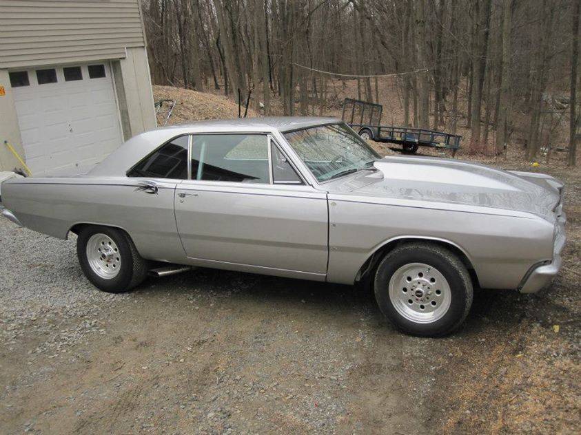

I ran draglites once upon a time.
It seems from what I can tell that you like the circular hole style wheels? THey work ok on your car because your car is rounder compared to a Dart or valiant.
Below is a picture of Draglites on my old car.
Below that is a picture of Draglites in black.. :thumbsup::thumbsup::thumbsup::thumbsup::thumbsup: love these...
